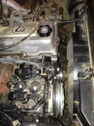

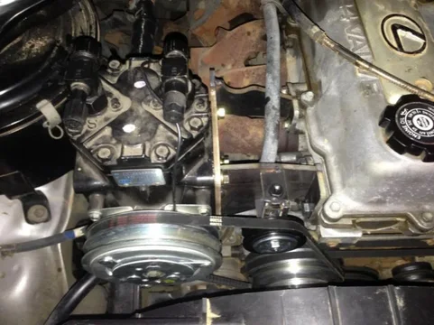

Making a couple changes to the model. A couple refinements and an aesthetic upgrade.
How do y'all feel about these being made out of stainless instead of powdercoated carbon? You could leave them a raw finish, where all of the color in the welds would be visible, or rattle can the bracket whatever color you wanted and never have to worry about corrosion.

Stainless tends to crack easier when exposed to vibrations....at least in my field of work. Not to mention the cost..I'll take good ole mild steel...my .02
Reason I ask, is because the price difference in stainless vs powdercoated carbon is a wash. That, and powdercoating adds a layer of outsourcing.
As for the strength, I'm not concerned about that on this bracket. There's a mechanical bond plus the welding.
Sent from my iPad using IH8MUD
All good then and understandable. I am good here.
Awesome, thanks for understanding. We're just trying to streamline the process a bit.
Raw steel w/ or w/o powder is fine and easier to repair if it cracks as scotia mentioned.
Mechanical bond in addition to the welded joint? Do tell.
The weld is NOT going to crack. This bracket is constructed of 1/4" stainless steel that is tabbed for figment which allows plug welding along with fillet welds along each joint, the weld will be the strongest part of the the bracket, the 1/4" plate will break around 90,000 pounds of tensile and it will break before the weld, Not to worry
Yeah, I meant to say mechanical joint.
Ultimately, I'd be more concerned with the threads in the aluminum head than I would the actual bracket.
