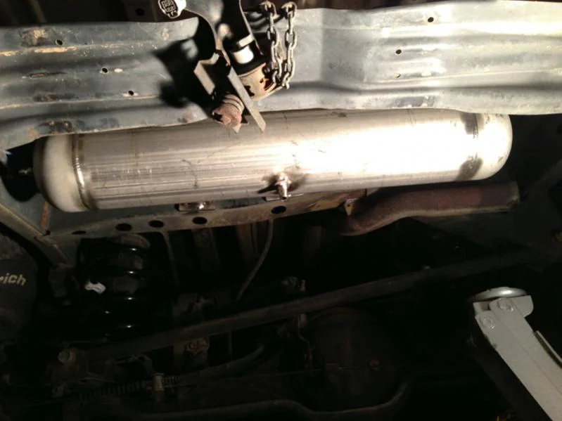

Well..... Can't guarantee it on your rig since you're running that big aux tank. Can you snap a pic under the rear of your rig? I'm trying to gauge how much room you have between the aux tank, and the rear axle.
These tanks will fit between the rear axle crossmember and the factory spare tire crossmember. The factory spare tire crossmember does not have to be there, just using that as an example to show location.
There may not be any room under yours... But, that doesn't mean you can't stop by sometime when you're in the area and we can make something work for ya.
There's hardly any room between the tank and rear axle - it pretty much takes up all the space from the rear axle to the rear bumper. There are a few areas I might be able to fit a smaller tank.

Slim tanks should fit above slider legs under rocker panels if tight for.rear space. I am figuring this out as well due to a LRT going in the rear.
Yeah, I had thought about that location. Might work out pretty well with one of these tanks, as the OD is less than 7".

Tim - Some of us are happily running the AJIK spare tire 'leveling kit', which raises the spare tire mounting crossmember. Many others are doing the same thing with the washer mod. Would that likely interfere with the tank location as you have shown?
http://ajikoverlandexchange.com/products-page/toyota-land-cruiser-80-series/1993-97-toyota-land-cruiser-80-series-tire-leveling-kit/
The crossmember itself won't interfere with the tank, but its likely that the tire will. Neither of us are running spares underneath there, so I didn't even think of that....
I'm thinking that everyone running a spare/aux tank underneath will need to locate their tanks to the space above the driver side slider.

Thats where my 3gal tank it located. Just hope when I do sliders I was smart enough the locate it right

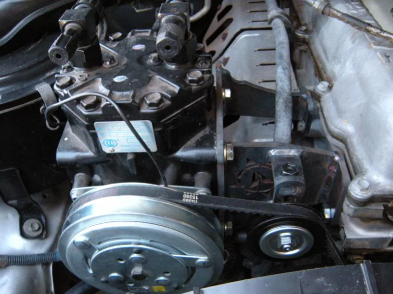

I have not seen any pics of the finished product. But I would like to pull the trigger. Do you have any pics of the setup on your rig? Thanks In advance!:D
