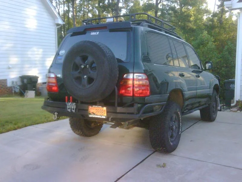

installed Bump it off road rear bumper
First I want to thank others for posting their installs and how to’s. Anyone in the Atlanta area is more than welcome to swing bye and see this quality bumper or borrow any tools you need as you being your install. :wrench:
I decide to go with the bolt on instead of the high clearance because I tow or use my bike rack more then I off road and the thought of cutting off the rear cross member :hhmm:. Another thing that I did not want to have to reach up and under the bumper to put the hitch pin on the trailer ball. I also had Mike cut a hole for a 7 pin connector so that would be up high and protected. I also got the ladder and a swing away rotopax carrer. It can carry all size cans. It also can be removed completely and stored. It has welded tabs on the outside of the ladder to attach. It is really cool and simple.
Hardest parts: removing the rear hitch, cutting the notch.
Most important: having the right tool angle grinder corded not battery powered.
Best Trick: The ratchet strap used to pull in the 100lb strut for the tire swing out worked great.
Who ever posted that double THANKS !!
Need the right tools. The rear cross member is extra thick where you are cutting / notching. I did not start with a corded angle grinder. If I had that one tool $40 at Lowes it would have saved me some time and frustration. Once I bought that tool the work was cake. Also Don’t tighten everything up until all bolts are on and threaded. I had some issue with one of the wings and need to loosen all bolts for a second time to get it on.
like others, I had the very rear bolts which hold the factory hitch on break off the captive nut inside of the frame and render that hole useless. I also had another problem with a captive nut being off center and unusable. These are used in mounting the support for the wings. It was suggested that I could drill into the side of the support and use the existing frame holes that are on the side of the frame. I think this is the best option; however I did not want to drill through thick steel. I went with a u bolt up and around the frame with the nuts at the top (protected). This was easy and seems to be very strong since the wing plate is there for upward force and will transfer the force into the frame and not on to the u bolt. If I was heading to Moab this may not be the best solution or you would need to use heavy duty u bolts.
All hardware seems to be excellent, I was missing some bolts for the latches which I ended up running over to Ace and picked up some stainless allen headed bolts, around $8. All drilled holes and fitted parts went on and lined up.
I still have to add the second swing out and ladder so more pictures of that to come.
OK here is the ladder and rotopax carrier installed.
The added can carrier really can carry just about anything from a single can to a double and could carry other items. It can swing either way and has quick disconnect so it can be removed quickly.
I went this way because I thought it was cool and I wanted the rear profile to be close into the rear. I bought a water pack and a gas pack so for on the east cost I should be covered.
I think it turned out nice...:cheers:

so... what's it like getting the spare up onto the carrier? I think I might have to set the tire on the toe of a hi-lift and ratchet it up.
it's a beefy rack to be sure. do you get any sway or vibration on the spare? that's a big weight to suspend up there and on a pivot arm.
