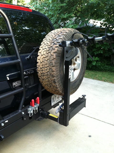

bike rack
Does a bike rack fit with a spare on back ?? It does with a BIO bolt on. I thought I would post up for those of you considering this bumper.
and this one too.
the more shots of it I see the more I continue to be impressed. Mike does some nice work!
Nice! I've been looking for a new bike rack and wanted to make sure it would fit w a spare tire swing out. I'm guessing by your photos the high clearance design probably wouldn't fit with your rack since its a few inches closer to the truck. Your new setup looks great though. Looks like you are ready for a serious road trip.
Thanks for posting. A bike rack for me is a must-have. I also wanted to keep with a tray rack as I usually have an all-mountain FS bike or two in the garage, plus I can't stand getting the front wheel to align perfectly so that the rotor doesn't rub.

I wonder how that "bolt on" BIO bumper campares to the Slee bumper. Do you know anyone that has a Slee that you can take some side by side pictures?
I have never seen a slee rear in person but did talk with some who had one and I looked at photos in detail. There are several small details that sold me on the BIO and lets face it the price was lower. The three things that sold me where price, struts on the swing outs, and the safety locking pin location is near the latches so you don't have to reach around your tire to open.
I don't think you can go wrong with either.. and if I lived near Slee and could pick it up , it would of made up the price diff. shipping was $$$.
