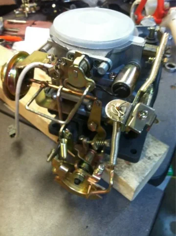

I tried to find an OE carb, considering the 3F carbs weren't ever a smogged item and would've adapted to a de-smogged, recurved dizzy, to no avail, but Marshall had a 3F knockoff.
So, have manifolds for a later head, later head is stated superior, already need exhaust, dizzy/ignition, why not go all the way?
That was my thinking, but after it being stated by the carb man in and FI world that the most critical time in a rebuilt F series is the first 30 seconds after starting up, post rebuild, I'm concerned if I can even pull it off.

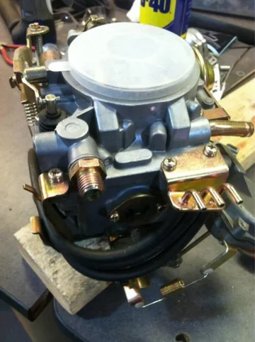

I know a few of y'all can look at a carb and determine the it's story. Myself, I'm clueless.
It's stated to be identical to the other Trollhole carbs, except the elongated base, so desmogged should describe.
Requested adapting to mechanical linkages, which was said to be a non-issue. Short of that, all else is assumed.
I did try to source a 3F Aisan and corresponding dizzy, internationally, but they don't seem to exist in abundance or from a source that won't have the Feds knocking on my door.
