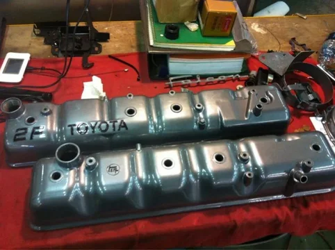

One wonders if an early '70s Clifford valve cover will fit a late 2F head...
the 74 carb which uses a clamp type of seal around its throat measured about 145 to bottom of band on throat...154 to top of throat. the 86 was about 150 to bottom of seal lip, about 154 to top of lip...not sure on the insulators, but maybe the carbs are pretty much the same but there is the difference in height of the cover? which would put the early 2F cover and air cleaner combo should fit the early or later carb, and the later cover and air cleaner combo will fit the early or late carb, the cornfussion grows from using combos of an early cover with a later cleaner and vise versa...I never laid hands on the right mid-late 70s carb to run the correct emissions which is why I ended up using the complete package from the 86 right down to the cat and computer...smog nazis:mad: I got a year and 3 months before I gotta yank off my intake and swap to the smog gear:doh: BUT, an old guy told me that's how you keep the smog gear in working order....only hook it up for 10 minutes every 2 years;)
measure the bolt centers...it looks REAL close;) and would be quite the cats meoa in these here muddy hills:clap:
edit: that says toyota...I'll bet it would fit, where do we get ours?
personally, I like the later valve cover better...it says 2F and TOYOTA on it, whereas the early one just has a weensy little teq stamp
Good point, as these later is sharp.

the early one is about 5/16- 3/8" inch taller(7-8mm) than the later valve cover. the early would prolly bolt right up to a late head. haven't confirmed, but guess the late cover won't fit the earlier head...
All I really need is a cover for the later head.
Not so sure I don't have one from the parts Pig purchase, since I vaguely recollect the one I unloaded saying 2F and chuckling.
Going to go back by and check in a few hours.
If not, still have access to the free 2F that I picked up at buddy's shop from the '80 40, since okiedave added it to his collection of stored parts.

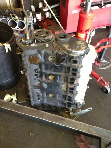

Only pic I have of it, whole.
What is that?
just some super cool piece of nostalgia that you must have for your project;)-as will I:rolleyes:

What is that?
Just a little sumthin' I picked up at the PNC swapmeet a few years back. Seemed like the perfect finishing touch for my built 2F. I just HAD to have it so I didn't bicker with the 20 dollar asking price...
Even came with the 4 matching chrome hold-down nuts.

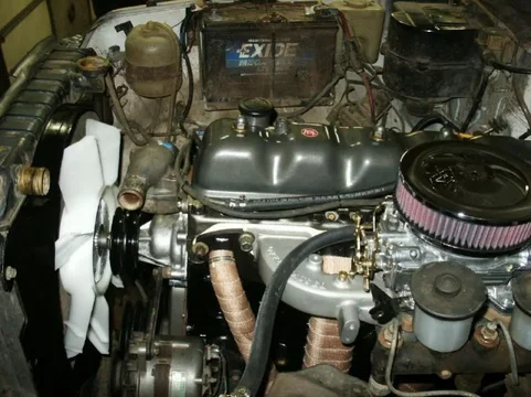

Ige posted this in the 76 thread.

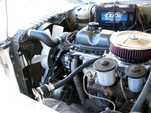

hhhmmmmm, a pig with a fan clutch.....like this?
And hoping to get more info on, more experiences regarding, since I'm returning other parts, ordering parts now that are incompatible with the H55/split case.
Again, an 85-87 head on a 76 block.
Is there fan options besides OE that hug the clutch like what I think Ige's pic is showing?
Help is appreciated.
I was just thinking off of the top of my head. I really do not know if it will be a problem. My guess from the pics is no. But a modified fan shroud looks necessary--maybe a thinner 2 core radiator--possibly a aluminum style one for fitment might be ideal.

A fanclutch does not like to fit between the 2F and a Pig radiator. It IS possible, with either a 2-row radiator or by moving the radiator forward (our Blue Pig runs a fan clutch). I never saw the need, TWRECKS has a direct-drive fan...
