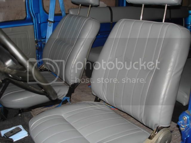

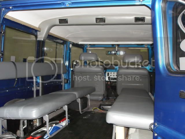

Updates to my troopy:
Here are some updates:
1) Changed tires from Dunlop MT2 (255/85R16) to Mickey Thompson Baja Radial MTX (305/70R16).

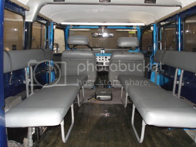

2) Bought original 2nd hand front seats. Had vinyl redone at a shop. Painted metal backs to gray. Overall, chose a lighter gray for frames and vinyl to give it a cleaner look.
3)Bought headliner at SOR/ Specter Off Road. Had headliner professionally installed at a shop.

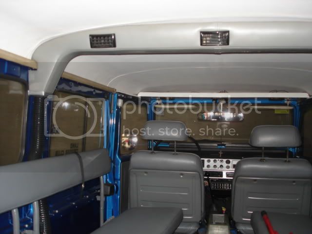

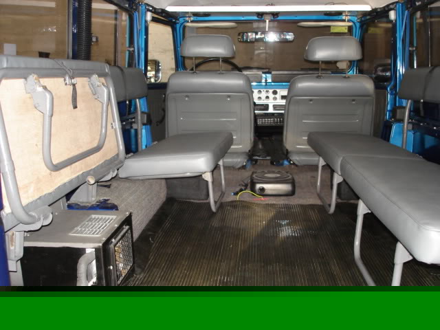

4)Bought hard to find rear troopy jump seats at US. Thanks Ken! Had to modify the frames /legs to fit troopy. Painted the frames to gray. Had the seats/ vinyl redone by the same shop who did the front seats.
* Took almost two days of labor with the help of a friend to have rear sets installed! Installed four jump seats straps.
5) Fixed Dual A/C. Had to reroute plumbing at the back because of the installation of the rear troopy seats. Changed A/C belt.

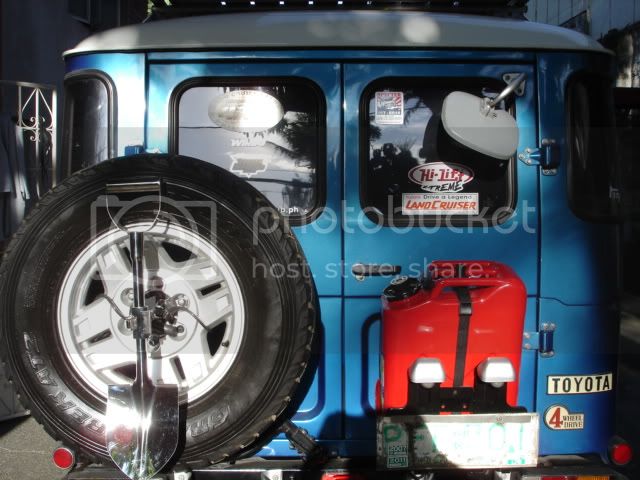

6) Finally, installed Blitz gerry can carrier and Blitz gas can (purchased both from US).

Wow, the seats look great. You should post in the regular 45 section and show off your work to more people.
Thanks for the compliment and for the seats Ken! Last time time I checked there are only 7 Troopys here in the Philippines. They were not sold here locally, only BJ/FJ 40 were offered here. So seats for the Troopys are hard to find. All of the Troopys (all LHD) were brought in by the Philippine gov't, Red Cross and United Nations as service vehichles during the 1980's. After their service, they were auctioned off to private citizens. Thanks.

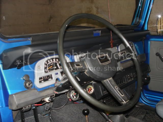

Updates:

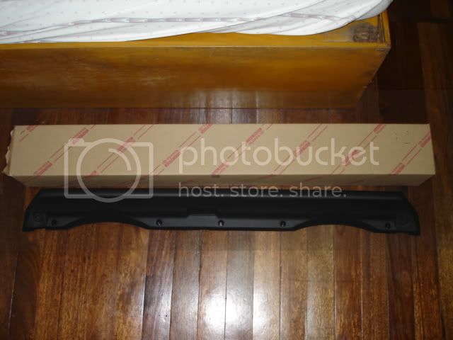

Bought a brand new upper dash pad. I am surprised they still have it it stock here in the Philippines! Got it at a good price, $200 less than what is asked for a brand new one in the US!
Installed in my Troopy.

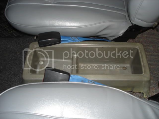

Installed center console bought at ebay/US (located at front seats).
Thanks for looking!:)

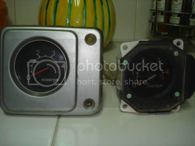

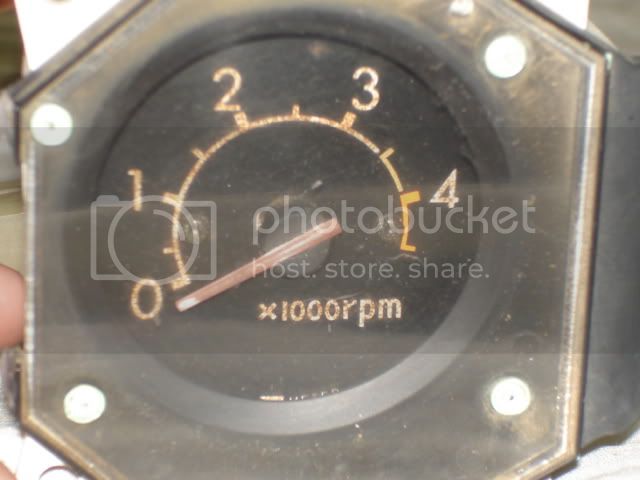

Finally got my Tacho from ebay Australia! It took 5 weeks but, it was worth the wait!
Here is the pic: (One on the left I got today, the one on the right is my old tacho without the bezel)

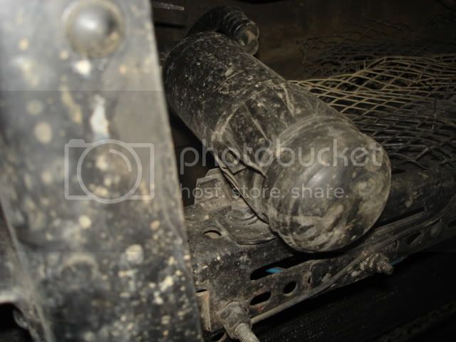

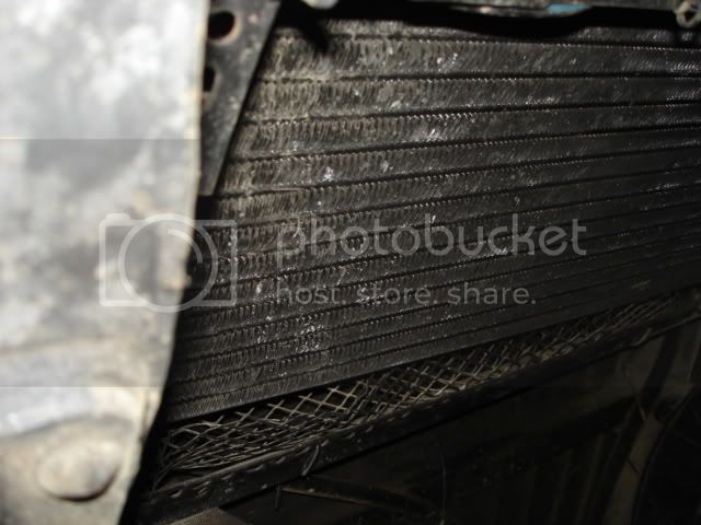

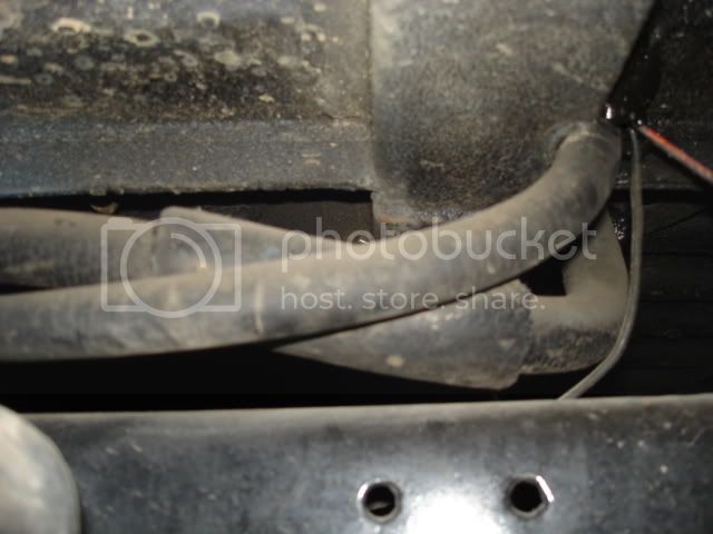

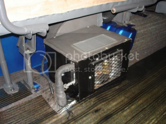

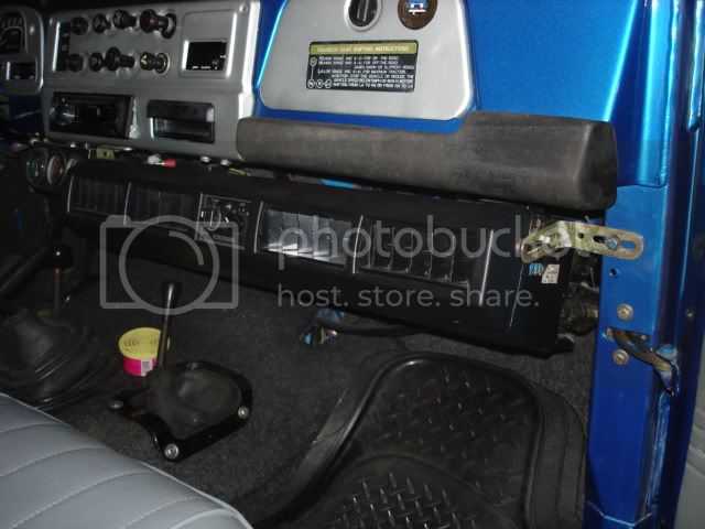

Hi boozewz,

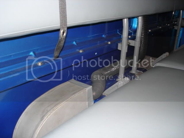

Thanks for the compliment! I am extremely lucky when I purchased my troopy about 2 years ago, the previous owner installed the dual AC set up in my troopy. It gets hot in the Philippines about 80 to 90 degrees normally, and 100+ degrees during the summer. I'm sure it's not as hot as the weather you encounter in Saudi! So AC is a must here in the Philippines, and single AC setup is too weak to help cool off the big interior of the troopy. My AC setup in the front is aftermarket AC while the rear I believe (not 100%) is taken from the 80 series Landcruiser. The front is a Yokohama brand, which you can purchase here in the AC shops, they are easily sourced. The back you are going to have problems, unless you are able to get your hand on a "parts car" LC 80. With a dual Ac setup, the interior gets cold easily, even during the summer, even if i put the knob in the low setting. Here are some pics of my dual AC set up (Sorry I'm having a hard time taking pics of the plumbing underneath my rig):
Thanks for looking!
Jay:)

Looking at the photos, a few questions about your A/C setup:
It looks like there are two separate systems: two compressors, 2 condensors, 2 evaporators, two blowers?
If yes,
Do the two systems operate at the same time?
Does this really lug-down your engine when they are running?
Does the rear system push cold air only through the two under-roof vents?
Does the rear system include a heater core to operate as a heater during cold weather?
Do the refrigerant lines for the rear unit run under the Troopy floor?
Where is the condensor located for the rear unit, and does it have its own cooling fan?
I don't see a heater unit for the front driver/passenger--is the front unit a combination heat/cool unit?
Thanks.
