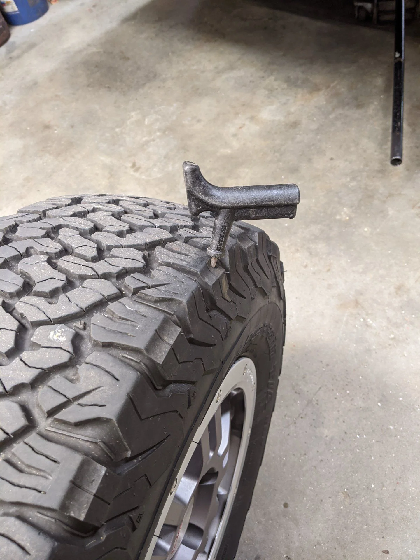

Came out to the garage this morning to find a flat tire on the truck ('15 200 series). Pulled wheel off, found a hardened concrete nail sticking out, rats. Location is right at the edge of the tread, see photo. Tire is a BFG KO2 LT285/70R17, still plenty of meat left on it, ~10/32" or so. All 5 tires on the truck have the same wear.
I put a rope plug in it, re-installed, just to see if it will hold air with weight on it. Looking for advice to see if it would be safe/OK to run. These will be swapped out to my winter wheels/snows about about 6 weeks, so I guess I could put it up as the spare until then, then decide what to do in the spring.
I'd take it to a good tire shop (where the folks doing the grunt work are not a bunch of teenagers) and have it dismounted and a boot (patch) installed on the inside.
A nail puncture is unlikely to cause a catastrophic tire failure.
I may give that a try, when I swap them for the winter. Meanwhile I took it for a short trip to "set" the plug and it's holding just fine. I'll swap on the spare just to avoid any surprises.

I would run the tire as well, FWIW. Not sure they will be able to put a boot in that close to the sidewall but maybe. Seems like someone told me once they can only go within 1" of the edge of the tread. I'm sure that varies by tire, shop, time of day, etc....
What did you decide to do? I have plugged tires in that same area before and never had an issue. YMMV. I recently had a young man tell me how dangerous plugging tires is. I smiled and just thanks for the info. I can't count how many tires I have plugged a tire over my driving lifetime I have done and honestly can tell you never had one fail or have to redo.
I put a plug in it, then put it up as the spare. A few days later, it was flat again. I realized that the rope plugs I had in my kit were really old, and the sticky stuff was probably no good anymore, so I bought some new ones and a tube of patching cement, re-plugged the tire. It held fine for 2 weeks. Now those tires are put away for the winter, and the snow tires are installed. If it's still holding air in the spring, then I consider it fixed. I have no concerns about driving on it.
