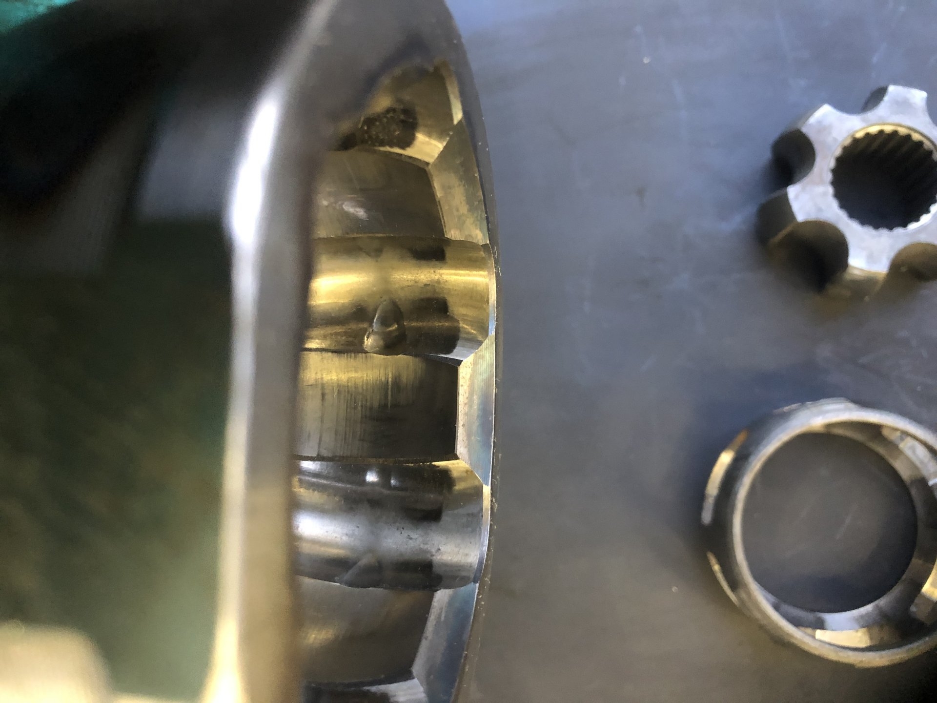

I’m doing front axle rebuild and have just taken apart the Birfields.
They looking pretty worn (check pictures).
It’s kinda a daily driver, so at this moment I haven’t got the time to wait for new joints. And it’s also a high cost at the dealer in my country.
Are they completely shot? Truck has 512.000 kms.
I'm not a mechanic, but I have serviced my front and rear axles. My birfields were a little less worn than yours at just under 250k miles. I didn't have the nicks in the cage like yours do but I did have the wear grooves in the star and wear marks from the ball bearings in the cage. If you don't have the money to get new ones I would reinstall these, making sure you install them to where the smaller of the two wear grooves is the one being used. Run them until they start to click.
If they ain't ratcheting (popping on sharp turns) start a savings fund and run em!
If they don't click I'd run them.

Yeah they have chips and nicks in every hole of the cage. I may have noticed some clicking at sharp turns but not extreme.
Anyway, they will stay in there for the next knuckle overhaul interval. Which is what for a road daily driven vehicle may I ask?
I wouldn't worry for street, in 4wd they carry torque, that will be when they grenade.
don't drive like a tard you should be good.

That's heavily worn and I'm sure they click hard in turns.
Since you're throwing it back together regardless, swap sides with the Birfield and cage left to right so the power side will be on the opposite side and then they will only click in reverse.

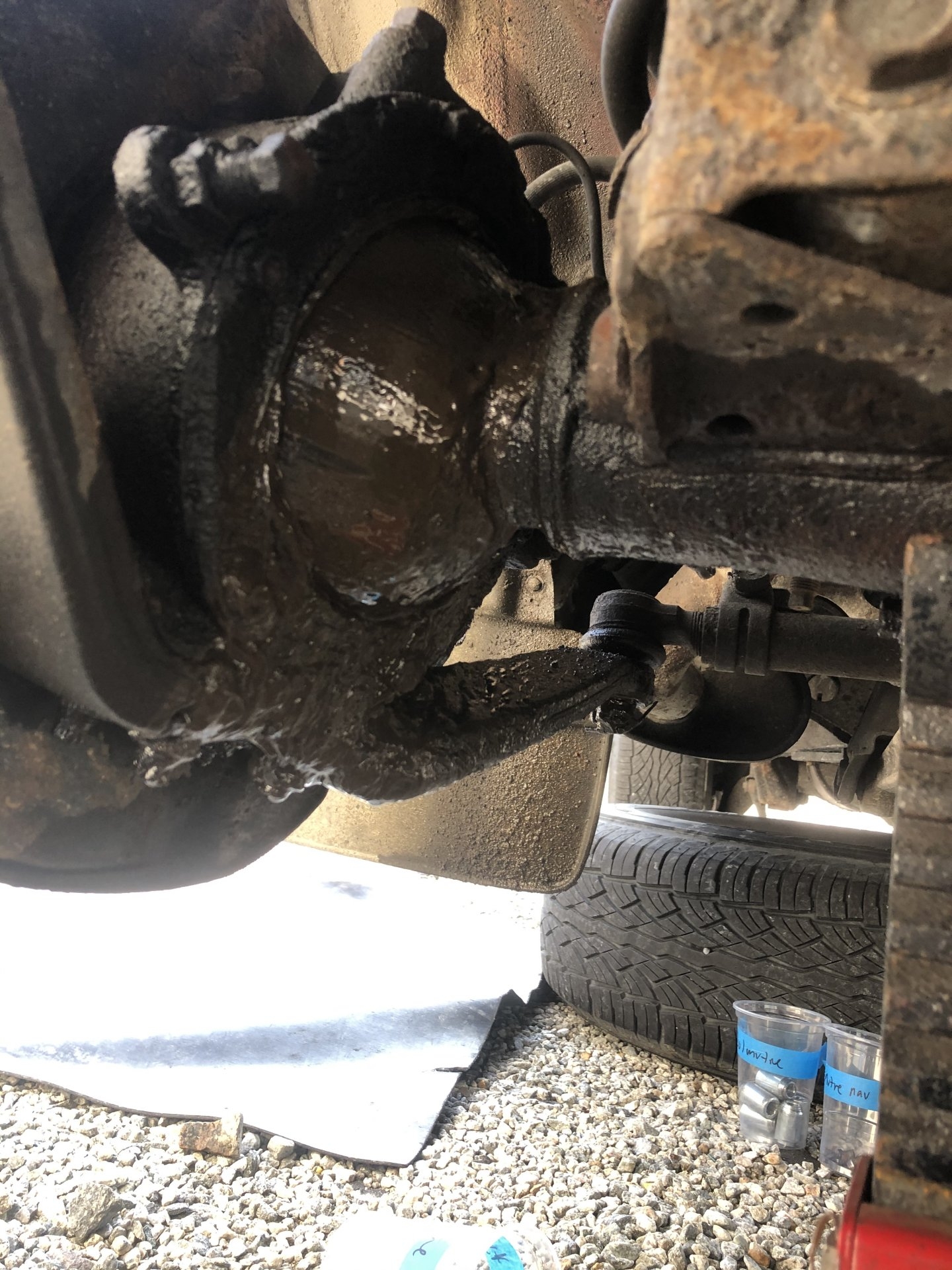

As you can see from the picture below, passenger side really needed a new axle seal. Funny thing is that I just had that hub out to replace some broken wheel studs. Started leaking diff oil right after. Strange.

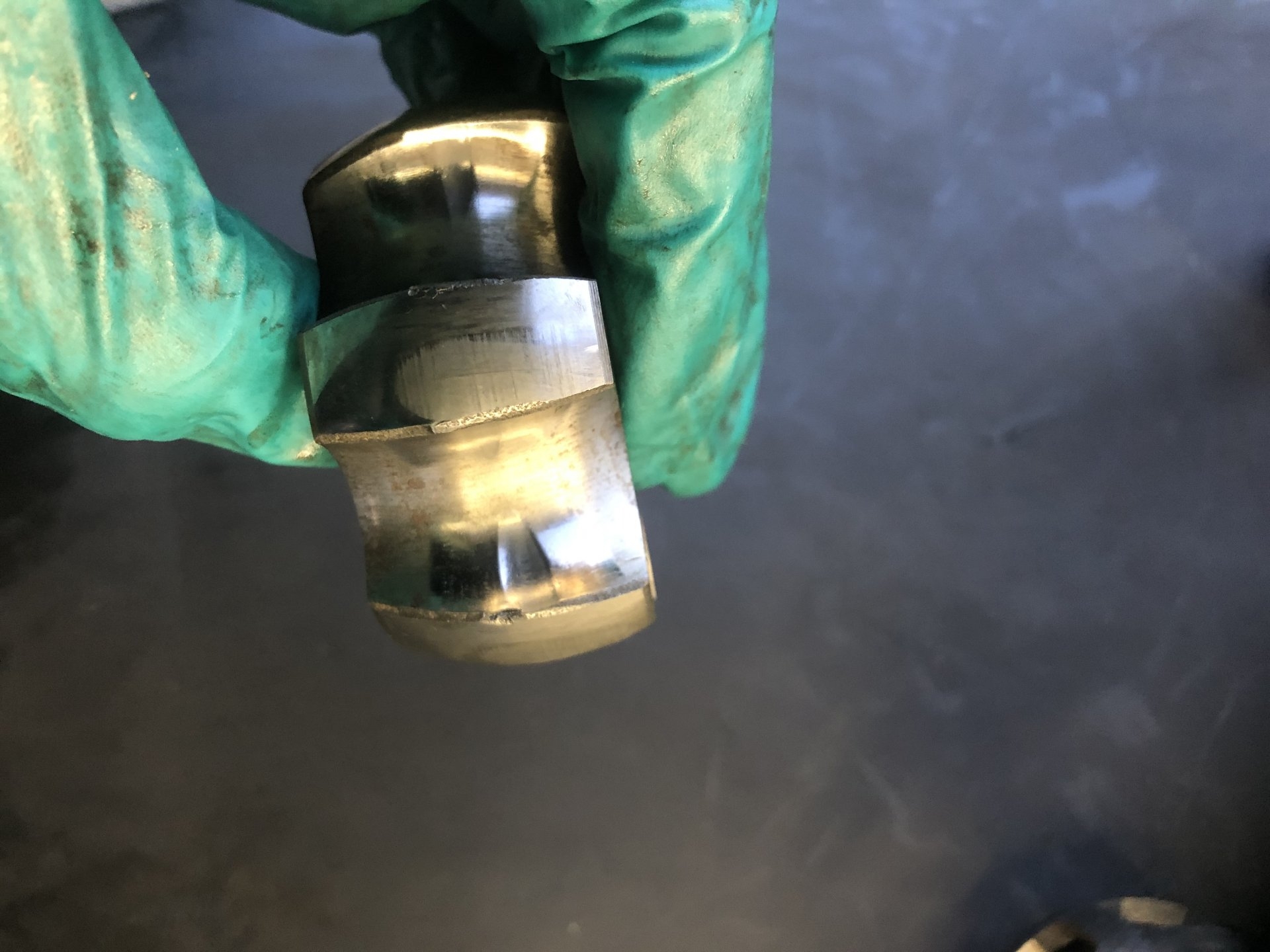

Passenger side may just have had the most worn out lower trunnion bearing in history. And some white plastic stuck in it. Check pics.

My trunnions were shattered when I pulled them apart from the PO.
