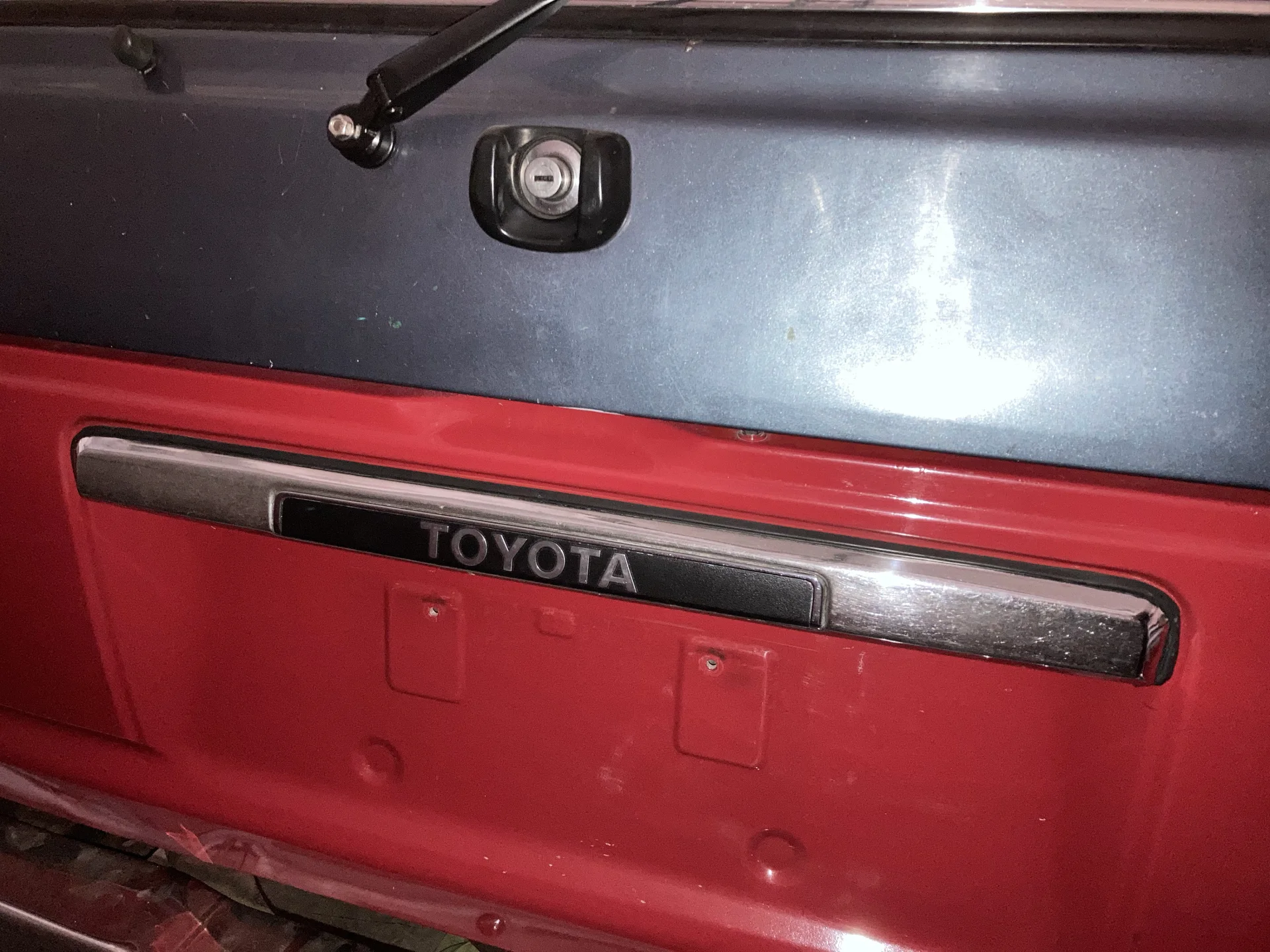

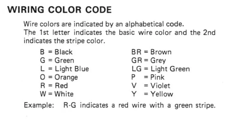

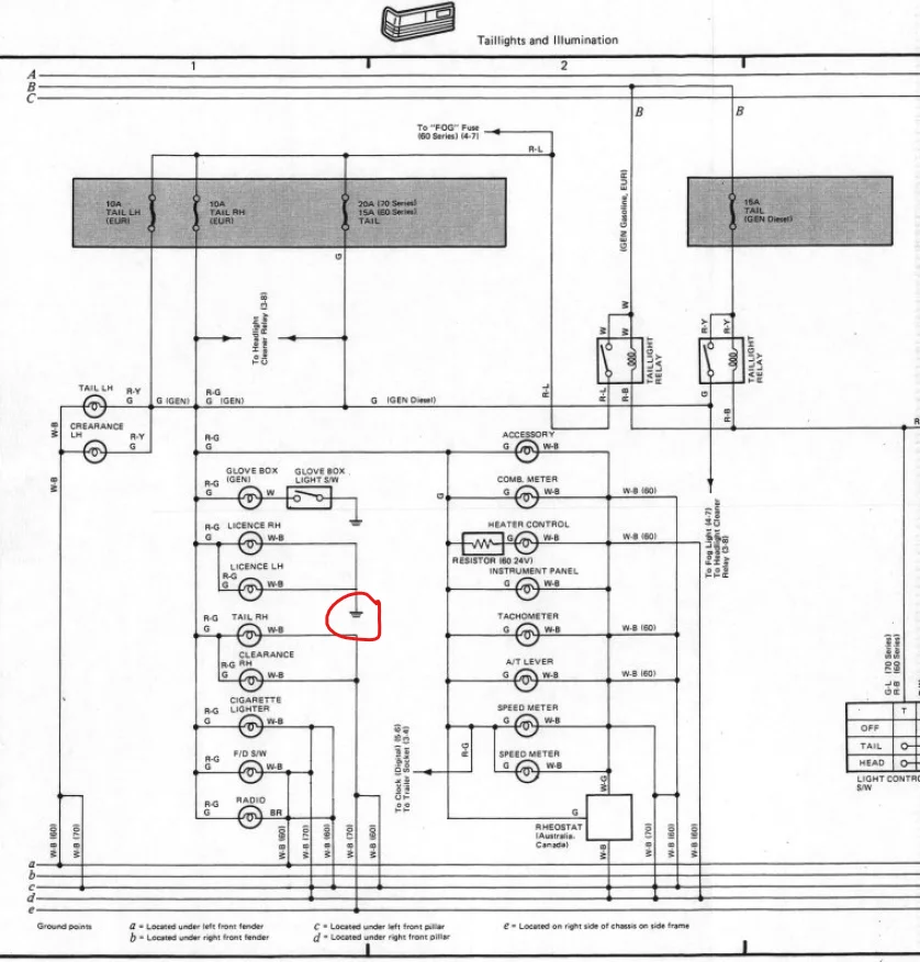

I just finished restoring my rear license plate light, but it's not working. This is the first time something didn't work after I did my diesel swap (FJ-HJ). Now I know the wiring is mostly the same between the 12V and 24V trucks, and since my HJ wiring diagram is too blurry to read, I'm using the FJ60 diagrams. But I can't read electrical schematics worth a crap, so can someone help me out? What does W-B mean? "G" I can assume is ground, yes?
Right now, there is no power getting to the connector at the tailgate. The bulbs are new, and test fine.
I guess what would really help is to know the colour of the wiring, and does that continue throughout the vehicle? My license plate bulb wiring looks like it's green with black dashes on it. But it's old and a bit dirty, and there are other wires that look pretty much the same so it's hard to trace this back. Shouldn't the colour of the wiring be noted on the wiring diagrams?
Any help appreciated.
