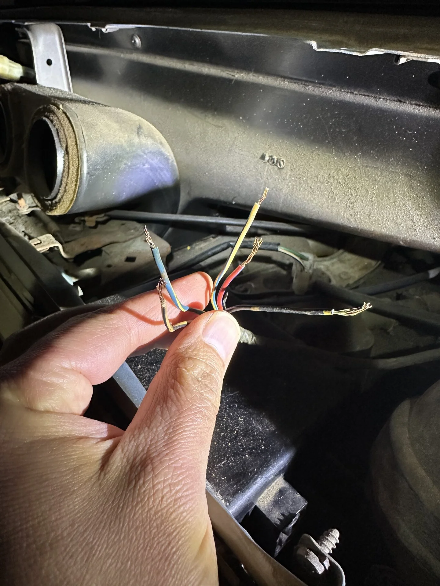

I’m trying to wire an aftermarket radio, these wires were right behind the receiver slot. The left two wires are showing 11-14 volts on a multimeter regardless of key in on position. I want to wire the receiver to constant and switched power. Will if have to fuse tap for switched power? Or what are the other wires? Antenna? Illumination? Ground? Any help with the matching up the colors would be great help.
I can't help identify those but I ran into this when putting a radio in my truck and just ended up running new wires all around. The ones that were back there looked crusty and not worth using in my truck at least after one of the POs hacked them up.
I ran a power wire to my fuse block for constant and then tapped into the cigarette outlet for switched power then ran new speaker wires to the doors.

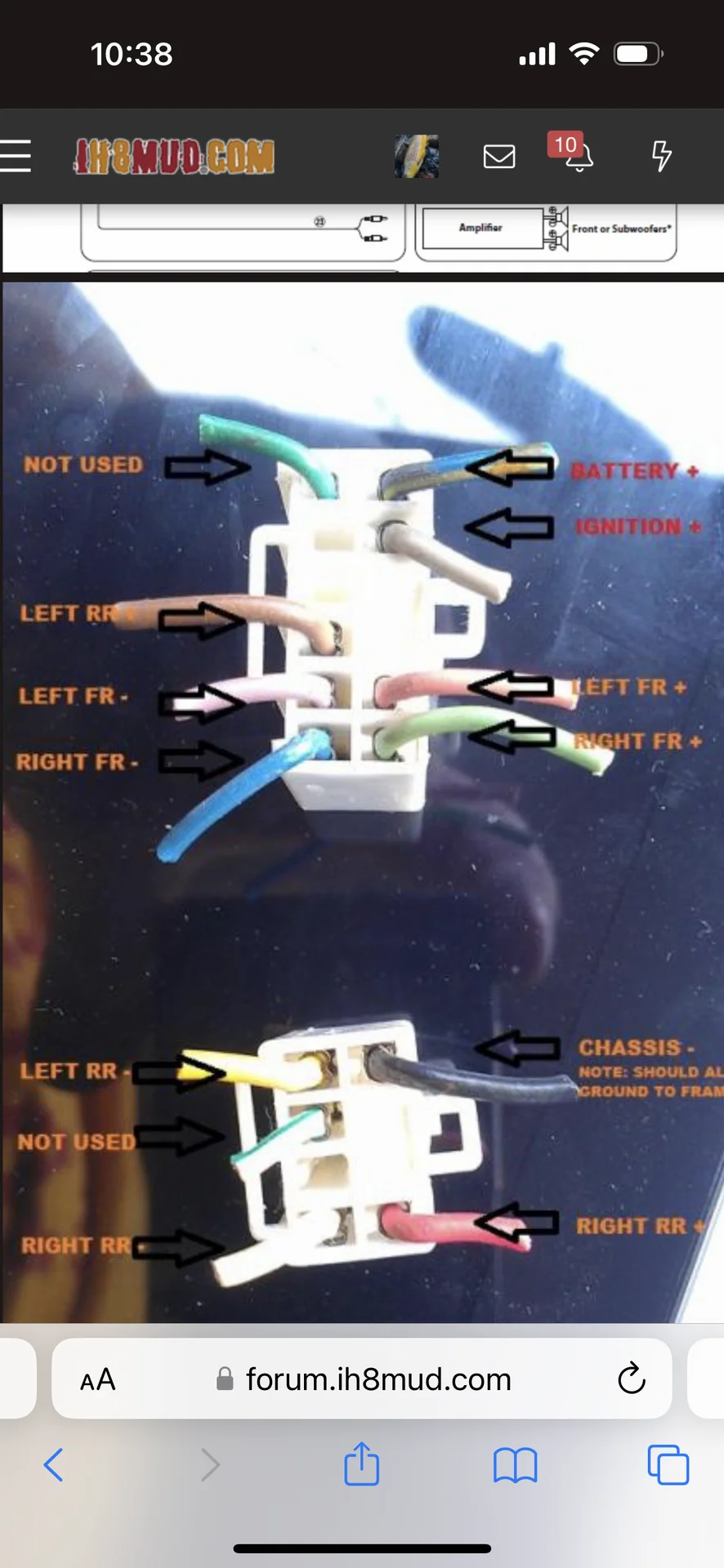

blue wire with the yellow stripe goes to your yellow wire (constant) on a modern harness.
Black with yellow dashes goes to the green and black harness for rear left ( which change color in the fj62 maybe 60? To a black wire and a yellow wire then to speaker in my case blue and gray)
Gray with yellow goes to red 12 V switched ignition
Brown with blueish greenish dash goes to black ground
All Blue is connected to remote wire which goes to amp. Amp has wire from unit to battery with inline maxi fuse.
The Chassis & Body factory service manual has a full wiring diagram in the back with the color codes of each wire labeled. I’d start there and test with a DMM to confirm.
All Blue is connected to remote wire which goes to amp. Amp has wire from unit to battery with inline maxi fuse.g
