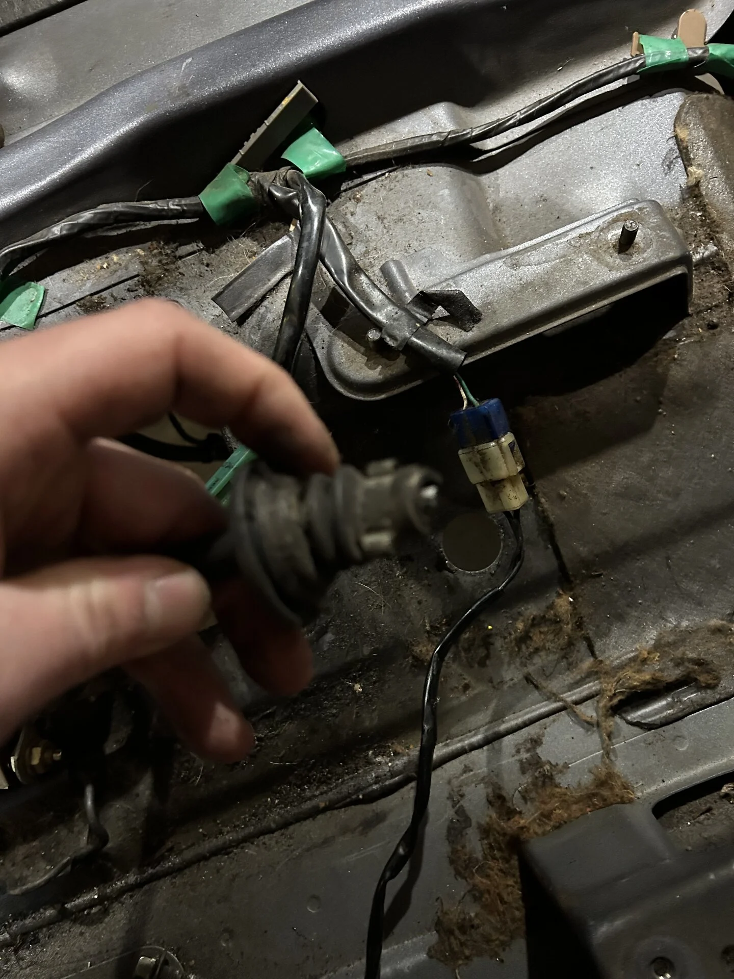

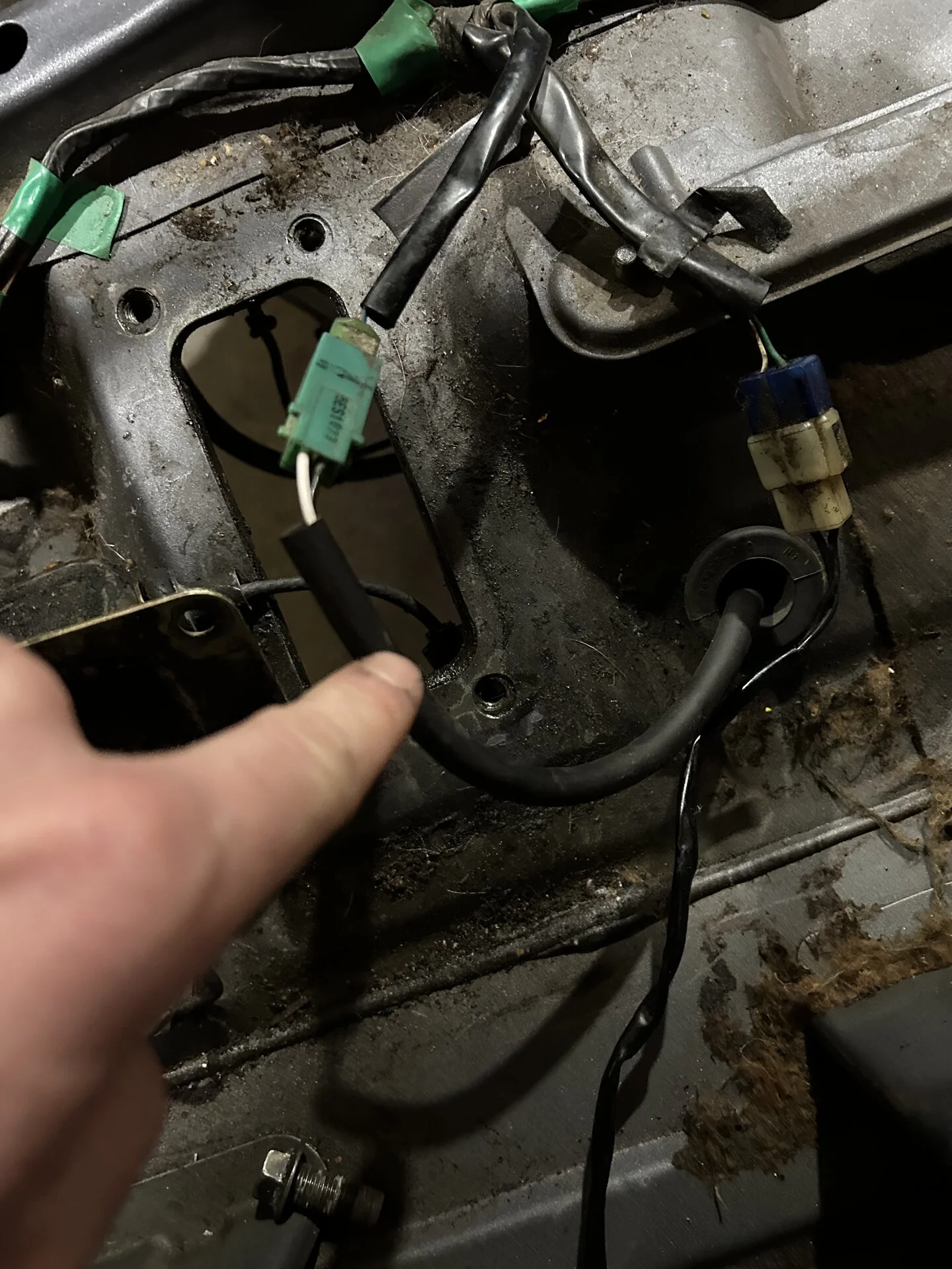

Well I’m hoping someone can tell me where these cut wires are supposed to go. This is on a 1985 fj60. I didn’t cut them so I’m not sure what they are supposed to be connected to. They come from the cab through floor. Any ideas would be helpful.

In the end of that rubber grommet are 2 wires who ever cut them cut them very short. They are black and white as far I could tell.
Gotcha. That area's out of focus, but I see it now. Still no help though. @roadstr6 ?
That is from a sensor that was mounted in the CAT. Just pulled one yesterday.
Ahhh you’re the best. Thank you. Stay tuned for more wiring questions. This rig was butchered when the first 350 swap went in. Appreciate your help.
