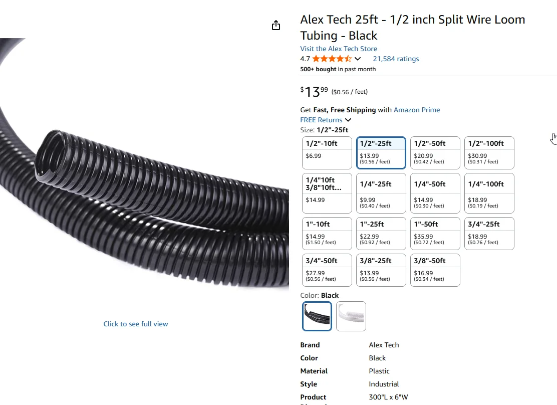

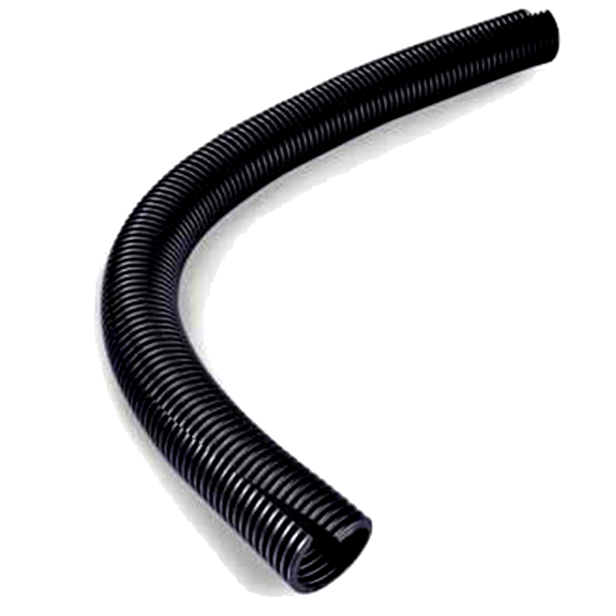

You need something heat and oil resistant (there is no UV under the hood, or anywhere else on the truck, for that matter), prefereably something purposely designed for automotive use. I used AlexTech split loom when I rewrapped the engine harness during an 80 series headgasket R&R several years ago. It still looks new.
There may be better products available; I grabbed that because I was in a hurry and haven't had any reason to search for anything better since.
