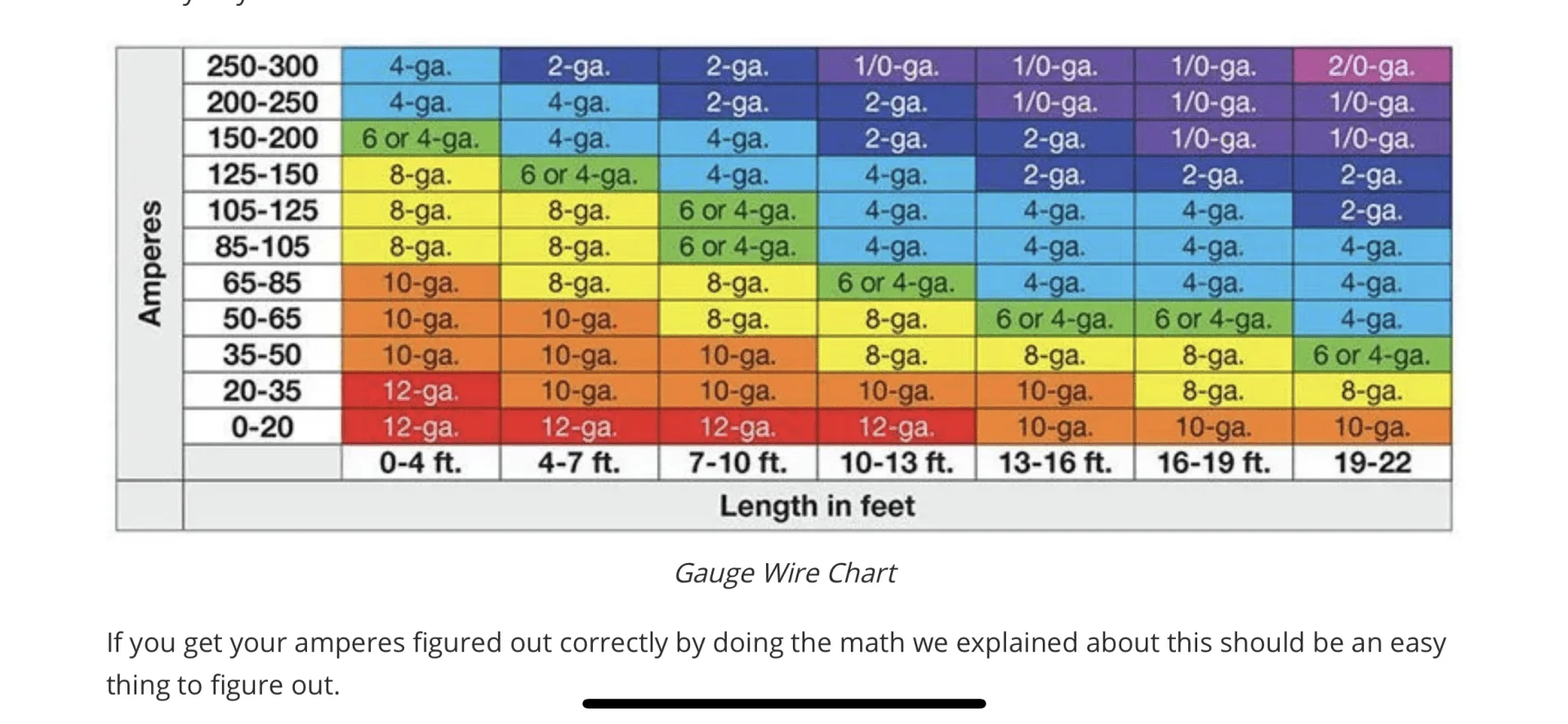

We're laying out the rear electrical right now for Julia's 80 (and my FJC, subsequently), and I'm finding a significant difference between various online wire sizing charts when researching length vs amperage.
Here are a few that I've seen linked here on MUD (and the one I've been using up to now, listed last.) How does one determine which is correct?
un-cited link from MUD discussion
(35-50a at 19-22feet - 6 or 4ga) (no temp reference)

As far as I can tell, all of these assume at 3-3.5% voltage drop for starting.
Thoughts? (No one wants to run vehicle-length welding cable twice.)
