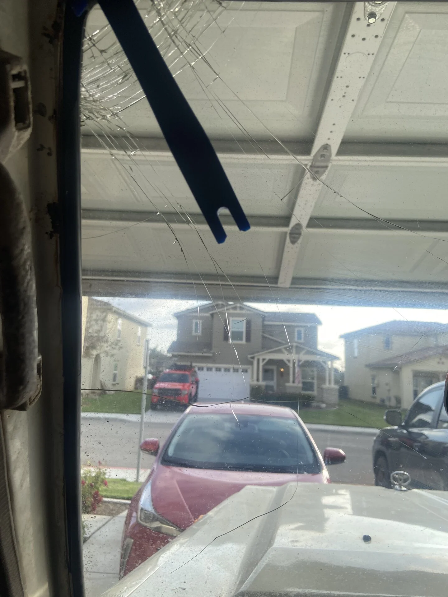

Absolutely. I broke my windshield trying to remove mine to take out the rubber.
I ended up cutting the backside of mine off to get mine out after breaking the windshield.

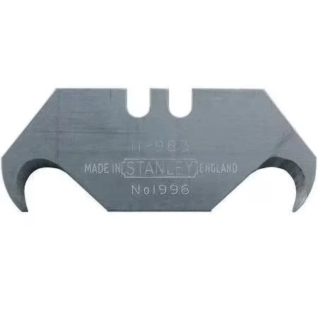

I just took mine out for other reasons but... pretty easy, just take your time and carefully cut around the outside until you can lift it out without trying to pry it out. if you pry it out? it will break. your not going to be able to re-use the rubber weather seal anyways. it's probably got some adhesive on it.
this is my favorite blade for this kind of stuff, works well and allows you control the dept of cut. should fit into most standard box cutting types.
