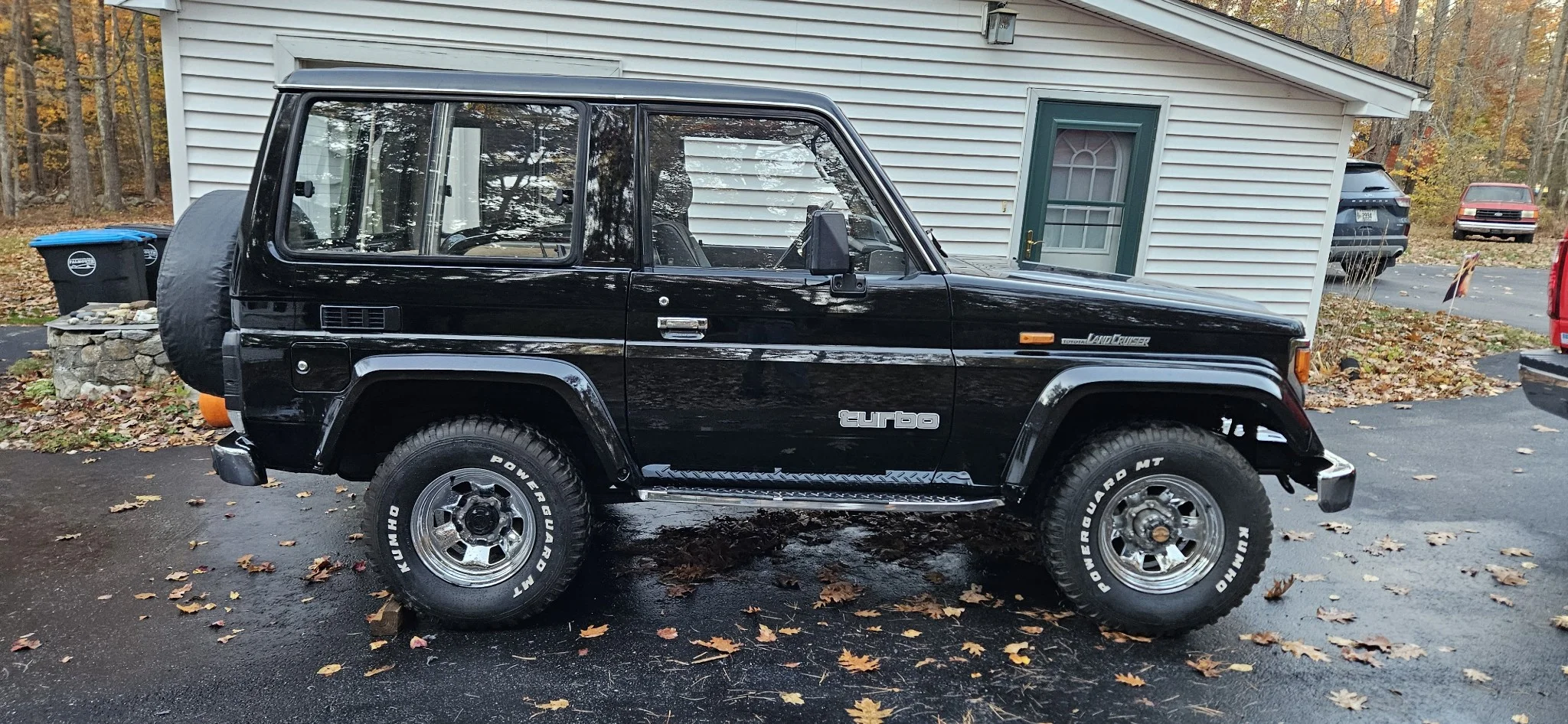

Hi all,
Does anyone have the part number(s) for the rear sliding window frame seals? (1989 LJ70) I need to fix some small rust hoes in the channel and wish to do the job correctly.
I see in my chassis manual (page BO-39) it has the remove/install procedure, but I'll need the rubber part numbers. And a U.S. parts source if possible.
the picture below is the type of window I have.
Also any tips and suggestions are welcome if you have done this procedure before.
Thanks in advance,
Tom
