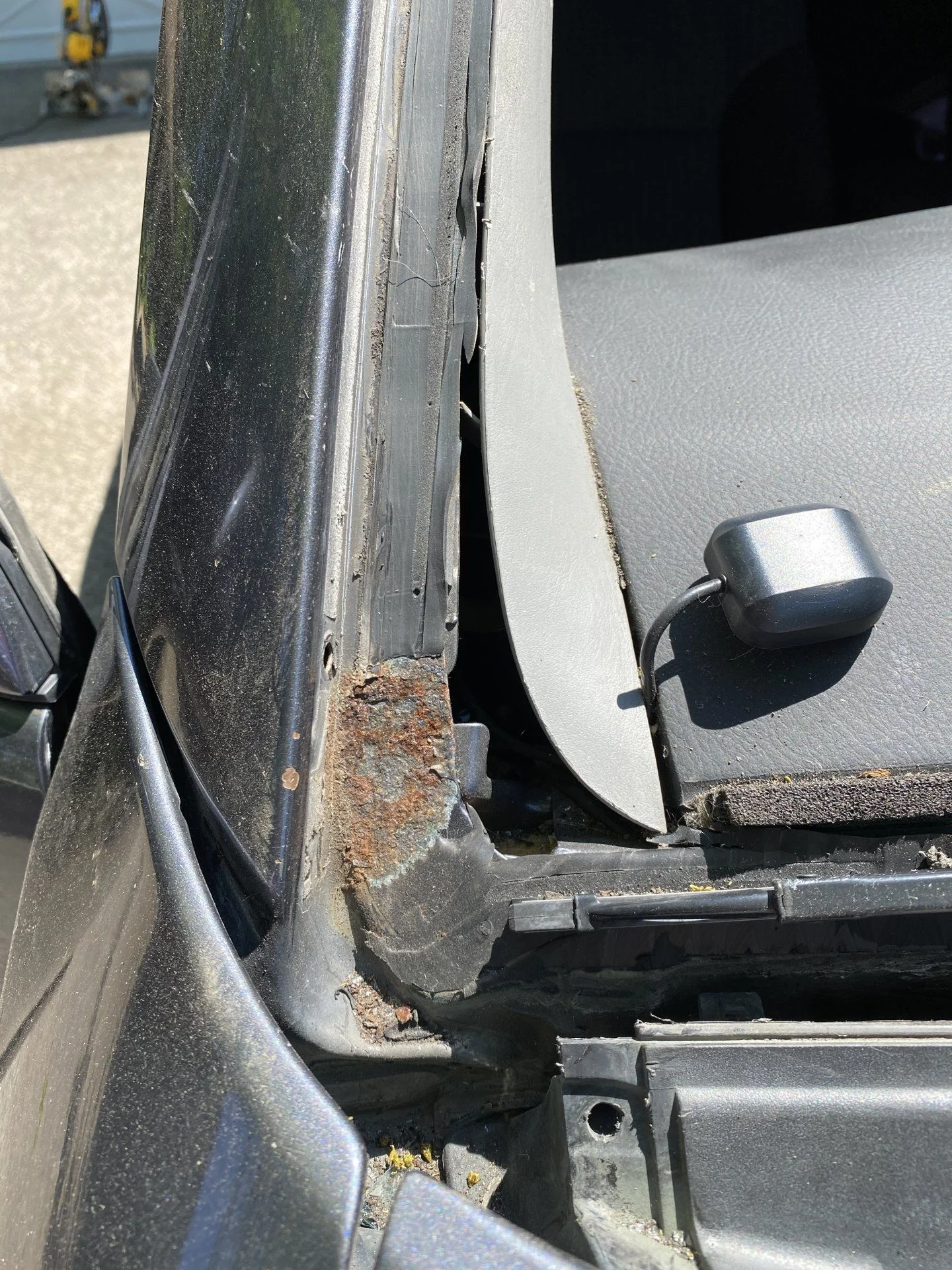

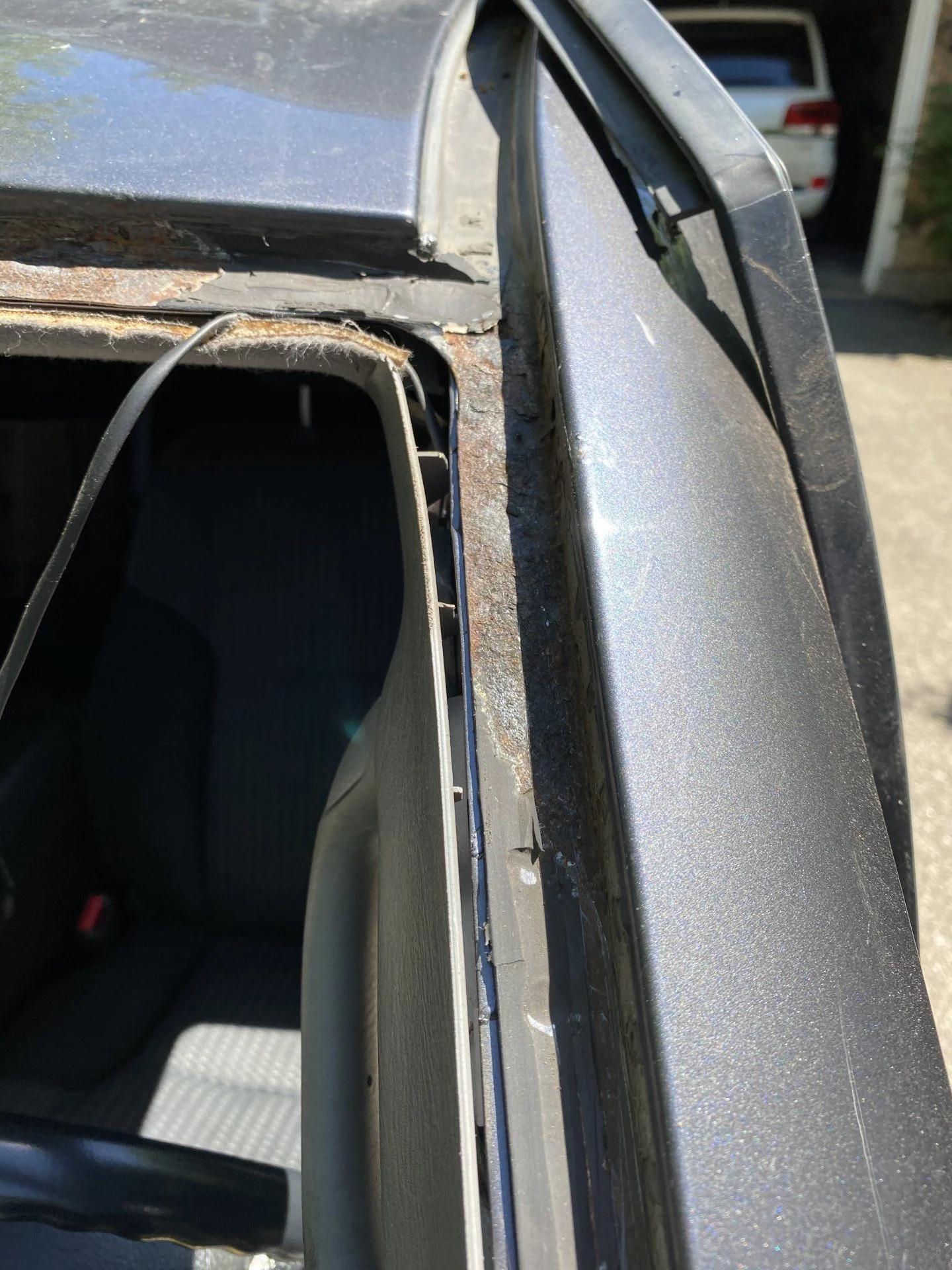

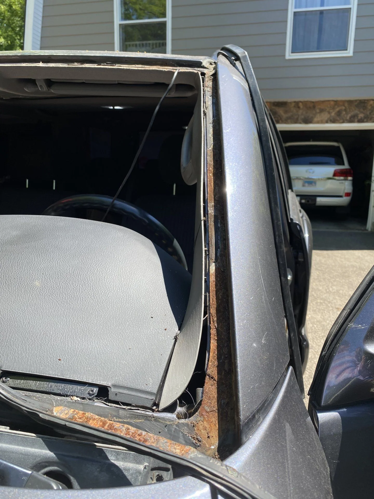

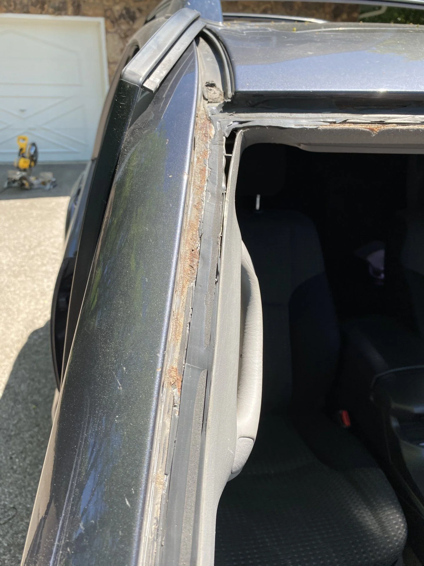

Some Safelite horror photos on my 4Runner. Rust from a previous Safelite install. Fought them and they covered $3000 in body work.
Wow...tough pics to see! Any idea if AGC windscreen is available through non dealer sources? The Lexus dealer where the truck is now, uses SafeLite (they are a pretty good dealer - Platinum/elite and GM is head of the Lexus dealer council).
