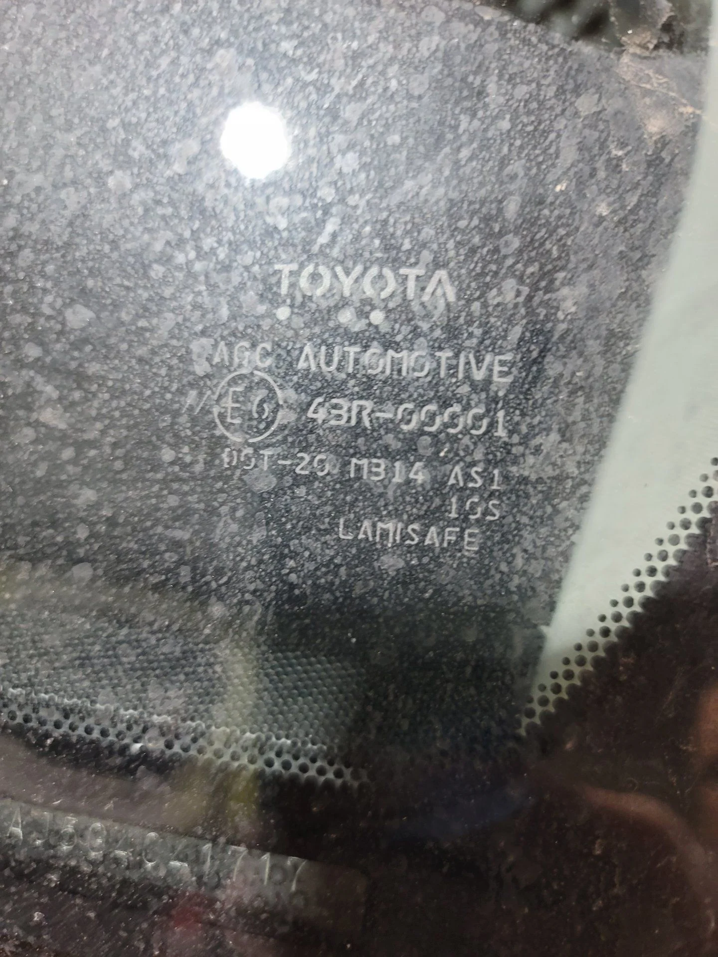

how can you identify an OEM vs non-OEM windshield?
True OEM glass has a Toyota stamp. I think most if not all Land Cruiser glass is made by AGC. I have also seen Toyota and Lexus factory glass made by Pilkington. OE equivalent is made in the same factory or factories as OEM, but no car manufacturer logo, Nd may or may not have the same specs (thickness, tint, etc.).

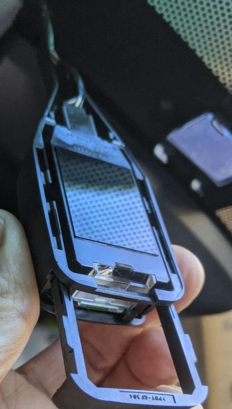

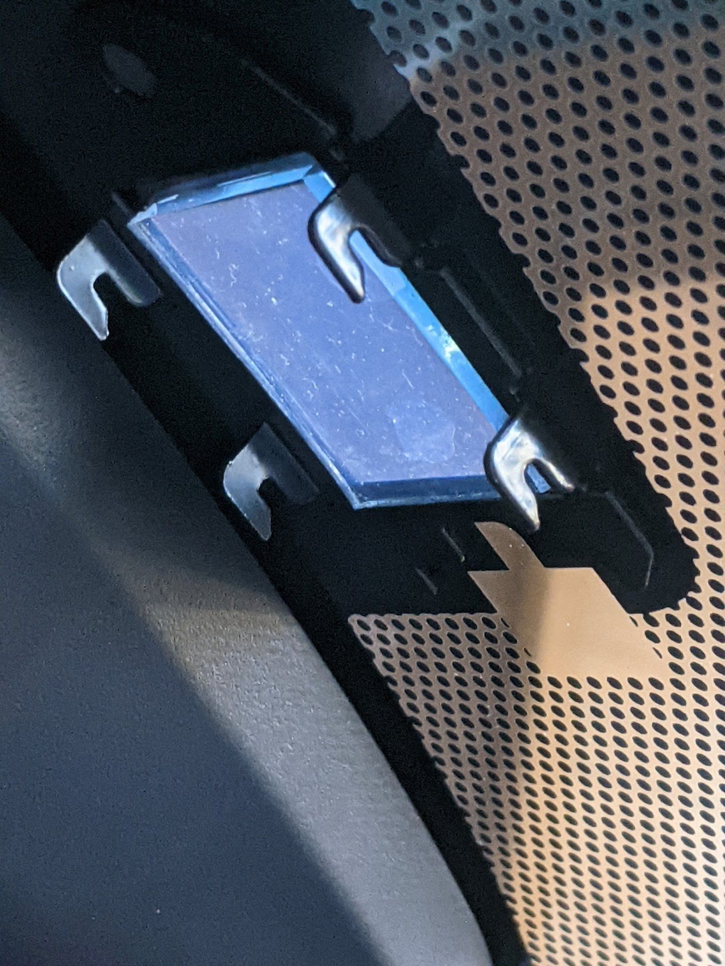

My pilkington panel is holding up well to rocks/gravel, but the rain sensor bracket isn’t parallel to the glass and the VIN window doesn’t line up. Also the wiper defrosters don’t seem to work quite like they should. All of these things wouldn’t be the case with an OE panel.

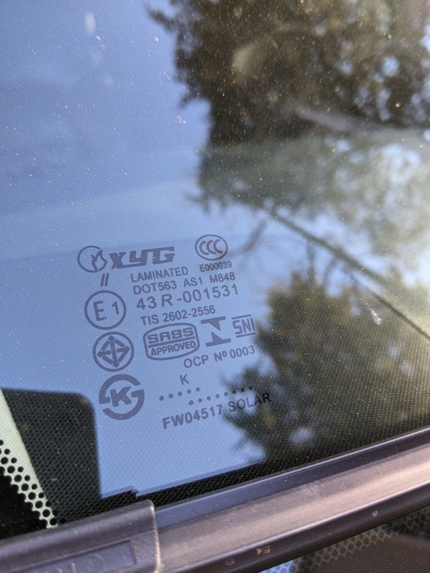

I'm happy to see the SABS seal of approval.
" The South African Bureau of Standards, or SABS, is a certification body accredited by South African National Standards, or SANS. The SABS Certification Mark acts as a third party guarantee of a product’s quality, safety, and reliability, assuring consumers that the products conform to specifications based largely on ISO / IEC 17065. "
SABS doesn't mean much. It is similar to SAE J673-201506. Yes, it means the manufacturer submitted for testing and it passed minimum safety and quality protocol. It doesn't tell you if the glass matches OEM spec, if the defrosted wipers is in the right spot and will operate to spec, etc. But it will be safe, but so will any other glass that is allowed for sale in the U.S.

Does the clear rubber rectangle belong on the windshield?
It is available as a separate part for $25-30. I tried replacing mine to make the rain sensor fit better and get rid of the bubble but it didn’t work.. the issue is the metal bracket not being parallel on my pilkington panel.
