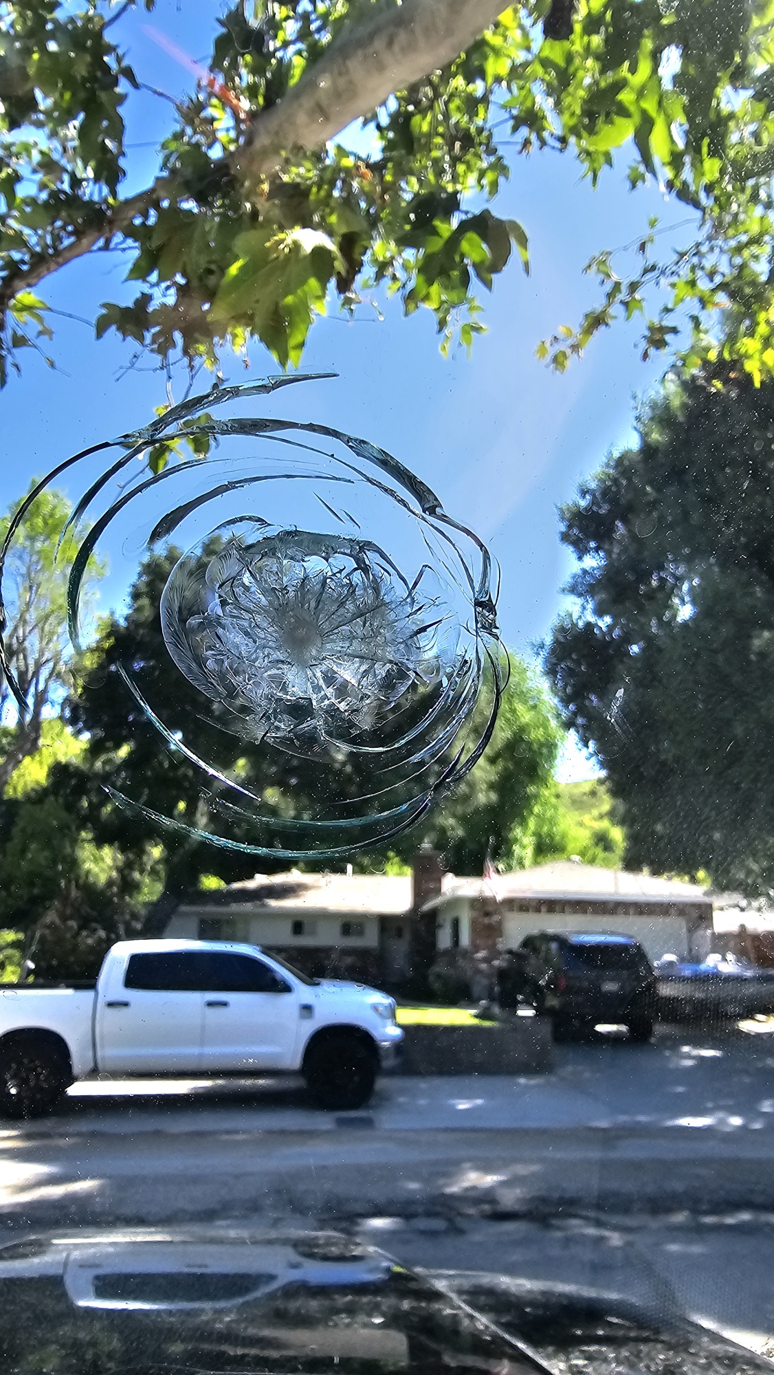

We had something hit the passenger side of the windshield yesterday - my wife thinks something got thrown off an overpass. Weird configuration, damage is about the size of a tennis ball, no other cracks. Fortunate whatever it was didn't come through!!! We're going to see what insurance says tomorrow. I'm sure here in Southern California, it's going to cost me triple what it should.

Don't settle for anything other than a factory original.
