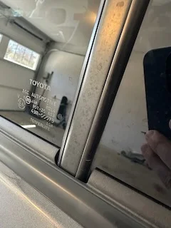

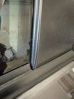

I ordered these part numbers for my 2019, they fit and clip in fine, but they do have some gaps where they meet the window frame. I am slightly worried about rain getting into the door, but it has been about a month, and lots of rain, and a few car washes, and no issues.

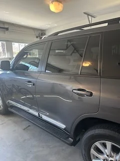

I wrapped the rear window using tape, it matches very well -

I taped the originals before replacing with the new parts, but it did not turn out that well. For some reason the tape turned out fine on the back windows. 🤷‍♂️
View attachment 3858346View attachment 3858347View attachment 3858348
