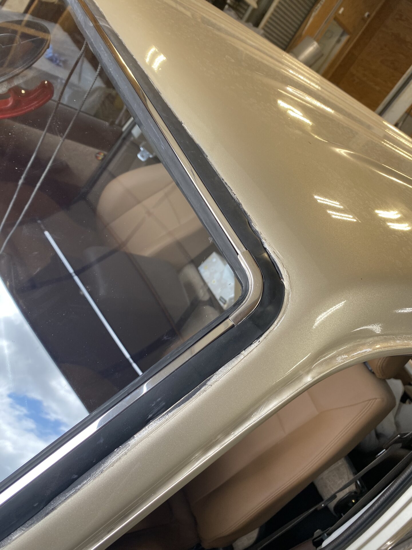

The bodyshop called and said something is off. The SOR gasket with channel fit proper to the Trival glass, 80-89 but approximately 1/2 gap sides and top. Sides barely touched, this doesn’t appear to be a scoot it over thing. Confirmed on invoices the numbers and description.
No modification to body, no damage, FG425 window fit fine.
At a loss. Any ideas which direction to go. Is this a gasket and window thing or QAQC Chin’r or what?

The glass guy was able to get another Fuyao same I have. KoolKatz has a good reputation and sells batches to Proffitt and they haven’t had any complaints. I’m not sure if everyone has given up on QAQC and nobody says anything anymore idk. I do have 2 of everything now including new chrome

Called Friday and deflected. Did a follow up email then and yesterday. No responses until I filed a dispute. Quoted their 14 day return policy and said “we sent you what was on the website, we’ve sold hundreds and never have had issues”. Also said “we sell dozens to Proffitt Resurrection and he has never had a complaint”. The fact won’t even acknowledge my request until I challenge on the money, then default to their policy, then say I’m wrong. I’ve got the windshield laying on top of what came out of it which fit fine, it’s an inch short length and width. Bought an FY and it’s fine.

The local Model A Ford club uses this shop I’m at now for all their work. He used his glass guy to find a replacement after my problem with Kool Katz. He has a FY and said it was already ready to install today. Also was $150 v $300 which is what Kool Katz charged me, plus shipping. I have another window guy local that has a 60 window in his shop. If you get in a bind I’ll send you his number. I’m sure he’ll sell it
Ok glass guy sent me the difference between proper fitted glass and the crap Kool Katz sent me. Part numbers the same. The bottom glass is correct, top is Trival. They won’t respond, their business address is residential and dba some other company that isn’t on a register anywhere. Good luck y’all I got screwed but I’m fixed. Hope that saves some pain from someone else.
Over priced and cost me 5 days at the shop, added approximately $1000 extra direct and indirect. I got screwed and Beth the owner was offended I’d questioned them.
