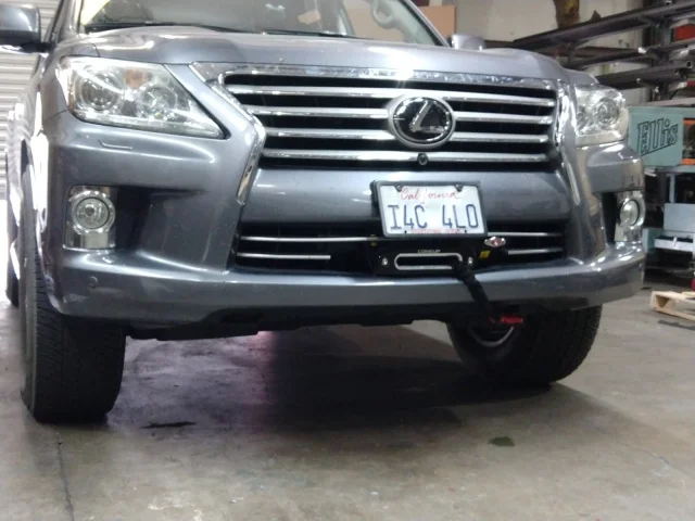

Just pulled the trigger on a Trail Tailor's hidden winch mount for 2014 LX570 specific model.

Anyone with recommendation and also where to find the additional fairlead as a spacer for hidden winch mount?

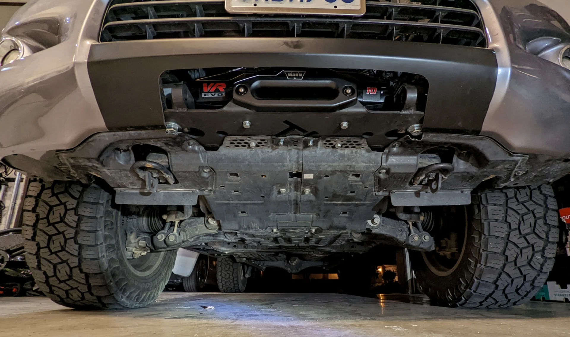

Ended up with WARN EVO 12K synthetic.
It was $750 with $50 mail in rebate and it’s fairly light, too.
7 year electrical and lifetime mechanical warranty is a plus as well.
