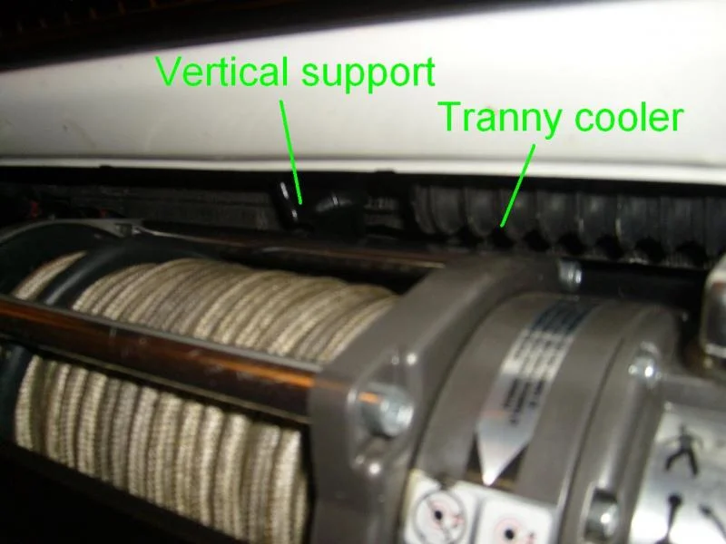

The problem I think youre going to run into is clearing whats behind the grill. If you move the winch up and cut into the grill, your going to have to mount it farther out in front of the truck to avoid the tranny cooler and the vertical support that it mounts too. So if you have no problem extending the bumper out, than thats fine. Its just may make your approach angle worse.

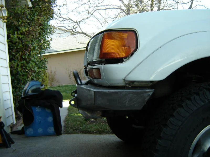

I built my bumper so the winch sits about half way up the frame rails. I also moved the tranny cooler up atleast and inch to get the winch farther back. Here's some pics...
Its hard to tell in the last pic since i took it so close, but the bumper sits pretty far back. If you want any other pictures for ideas let me know.

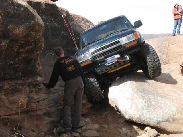

With a 1.5 inch BL and an Warn M8000, my setup works great. The winch sits on top of the frame rails.
And yes, an M8000 is a fine winch for an 6000 lb vehicle for the type of wheeling that I do.;)

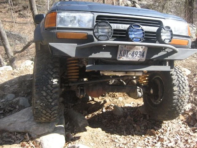

Here are some pics
As you can see with the plywood where my approach angle would be if I switched to sythetic rope and the small fairlead
The large fairlead does take away some approach angle but not that much and would be much worse if it were mounted under the rails
I do wish I did a cleaner job of cutting the valance below the grill but oh well $hit happens and I dont care to much any way
I think that the approach angle turned out better than I expected and I am happy with the result.
The control box is just zip tied to the grill for now until I get around to remote mounting it under the hood
Also now I need to make me a new tube bumper to go around it all.
I wish I had the funds for the synthetic rope but it will have to wait for now

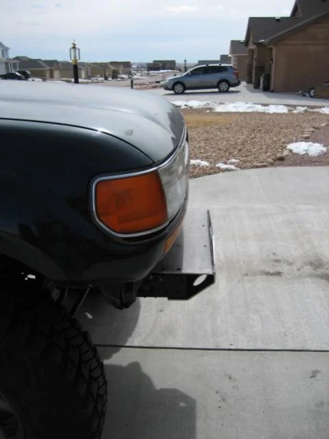

Here are a couple of pics of one I just built for a rolled 80 that's getting tubed out. I think it's about as tight in there as you can get without modifications to the grill supports, ps, etc. I would recommend you find a cast hawse fairlead like this one designed for wire rope. They don't stick out near as far as the roller type.
