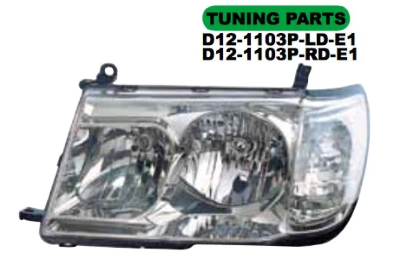

For a similar look, at a more reasonable price, you may want to consider the Depo "one piece" lights:
98-2005 Landcruiser DEPO 1 piece clear head lamp Interest

Cheaper option will be DEPO 1 piece headlamp, direct drop in plug and play. I carry the DEPO 1 piece headlamp if you are considering this option =)

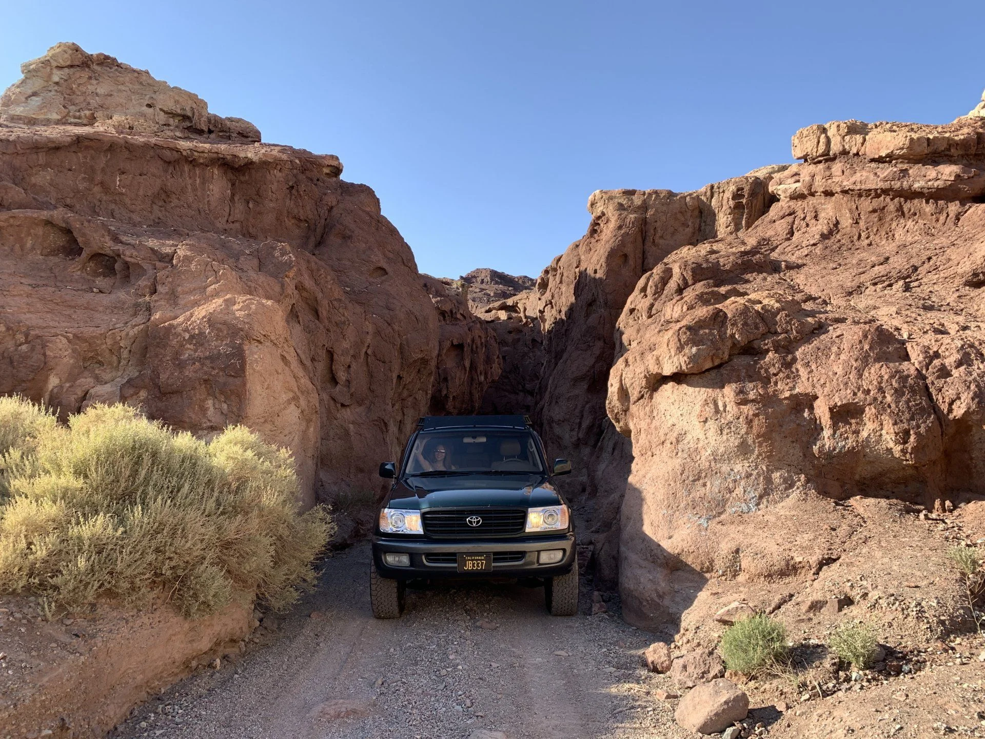

Here are the one-piece Depos, on my 2000 LC.
Thanks.....I have seen your post about the depos, and sort just wanted stock, but it looks like yours is the better bet for a one piece head light/marker

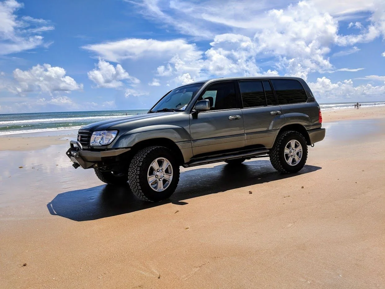

18" 2015 Tundra rims, 285/65/18 KO2s, 1.25" Bora spacers.I know the one piece looks really sharp, but if I can rig-up a $65 marker light, the rest of the $$ for a depo can go to a new RTIC cooler. Although I have been f-ing with this light since the fender bender, it just wasn't fixed right. Decisions
Are those 18" rims?
