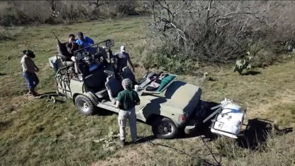

Hey guys, Newbie here, I've learned a lot lurking this site over the last few weeks, the biggest thing I've learned is how little I know, thanks for that. Here's my rig:
This Cruiser has been putting around ranches in South Texas for the last 15 years. The Smog Pump locked up recently and I am replacing it with an eliminator pully. I'm also replacing the China aftermarket carburetor with an after market Fuji.
Off and on for a couple of years now I have been experiencing what I call "won't hold an idle", it runs strong but dies immediately when you take your foot off the peddle. This problem comes and goes. The current plan to address this is the carburetor, clean out the EGR, replace the 3 port Vac Gas Filter (all ports are broken), and hook up/plug vac ports (most of which are disconnected).
I'm not out to do a full Desmog, I just want my rig to start every time and putt around a ranch reliably. But eliminating the Smog Pump feels like I have started down that road, and I question if I don't do a complete job then I'm going to continue to have vacuum/emission system issues down the road (if not worse).
So here's my question(s):
1. Half-Ass De-Smog - If I only eliminate the Smog Pump and do the things above will that likely lead to more/extended problems (because I did it Half-Ass)?
2. De-Smog Lite - I found a "Full De-Smog Kit" available: Toyota 2F Engine De-Smog Kit for 1980-1987 Toyota Land Cruisers - Landcruiser Parts - https://manafrelv.com/product/de-smog-kit-for-fj40-fj45-fj60-toyota-2f-engines-sku-2fdskit/ but I'd call that kit a "De-Smog Lite" compared to the Full De-Smog described in the "My Desmog Thread", including the set of instructions provided by @Borick attached below. (Thanks for doing that @Borick).
Would this "De-Smog Lite" Kit be ok to do without the rest of the Full De-Smog, or am I setting myself up for problems without finishing the job fully?
Last thing, I drive through a lot of tall grass, like half way up the radiator tall grass, and it gets compacted above the skid plate. Sometimes the catalytic converter will catch the grass on fire (I keep multiple extinguishers in the rig). @Borick's manual says "Without the AIR system, the cat should not get hot enough to melt down". The "should" in that statement makes me nervous. So would a Half Ass De-Smog or De-Smog Lite be less likely to increase temperature in the Catalytic Converter (as compared to a Full De-smog)?
Sorry for the long question, I mostly need to know what level of De-Smog I need to do for this hunting vehicle, we'll figure out the stalling issue. Thanks!
Some more pics of The Buggy:
