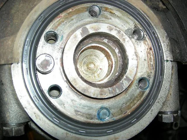

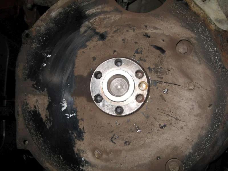

Well, I may be guilty of assuming that the 2F was just like my 3B, but that diameters of the bolts and pin didn't strike me as very different...
Apart from that I agree with you.
The threaded holes in the end of your diesel engine crank look larger than those of the gas F/2F:
attachment.php
F/2F
attachment.php
Oh, and would you look at that! A broken bolt!
