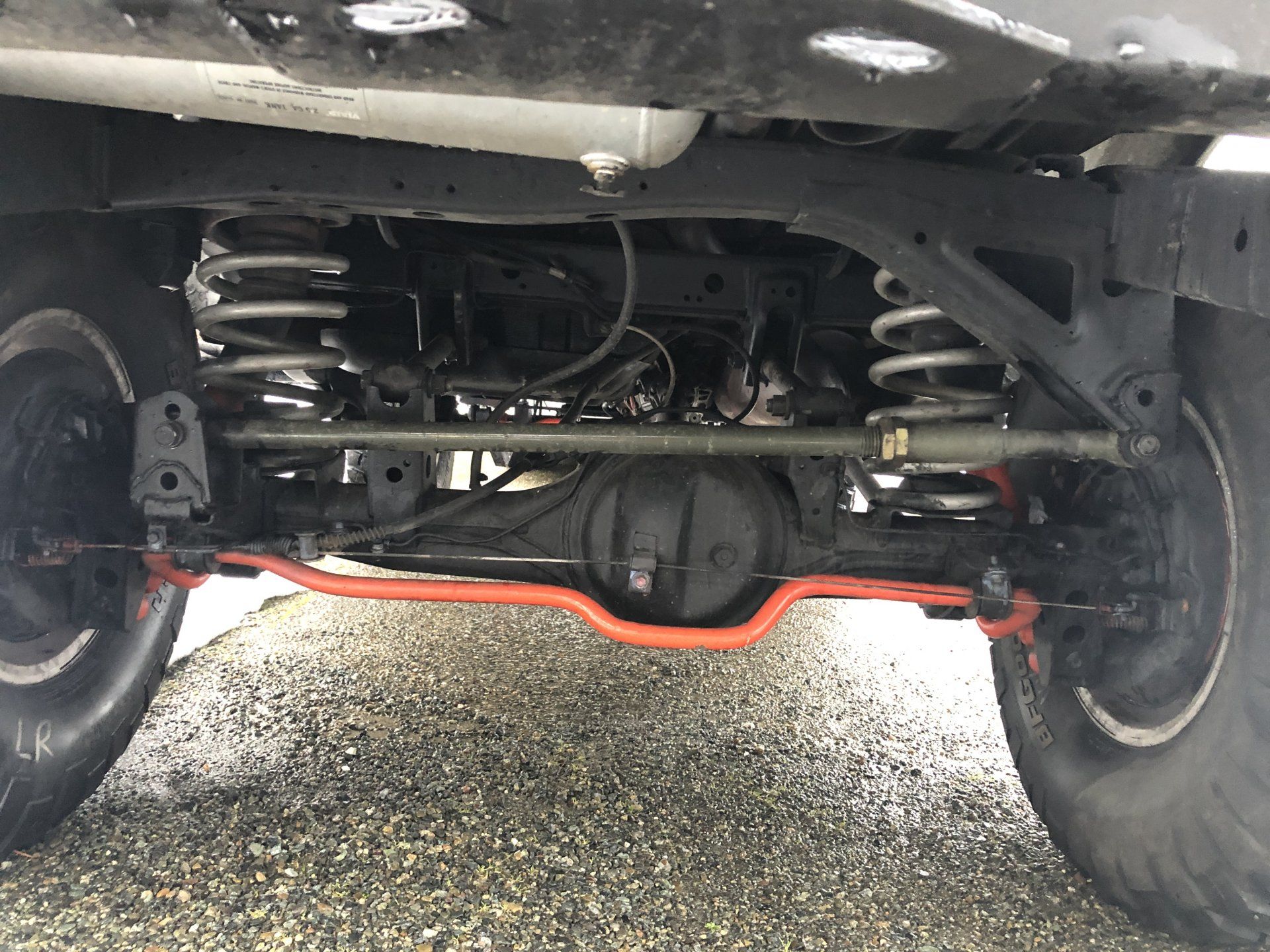

Obviously don't take my word for it lol, but I think they go here.
Maybe someone else can verify.
I believe the front frame bump stops only came on the 93-94s. I had them on mine and pulled em off when I installed swaybar disconnects.
