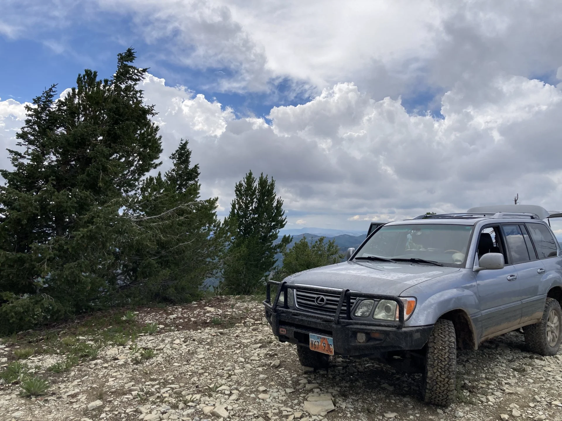

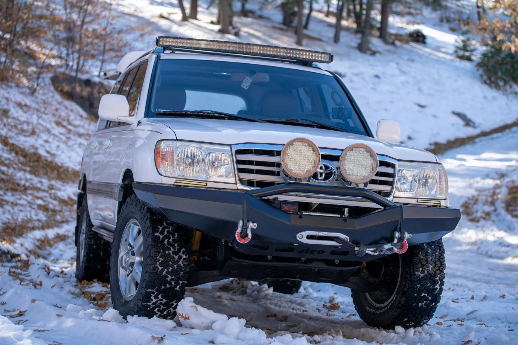

Slee--but I spend most my time in CA and AZ. BTW, just changed out the rear to a slee and removed the resonator and moved the tail pipe to just behind the tire--better angles going up and down.

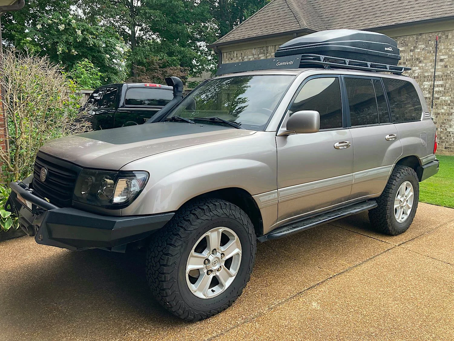

It was available locally (on sale) at the time when I need to purchase it. I decided my first bumpers to be more of a learning experience about what I really like.
It is difficult for me to make a decision about a bumper wihtout actually seeing one in person. That's where going to a meet can help.
So I Just followed the bog for now and may change later on when I have more experience.

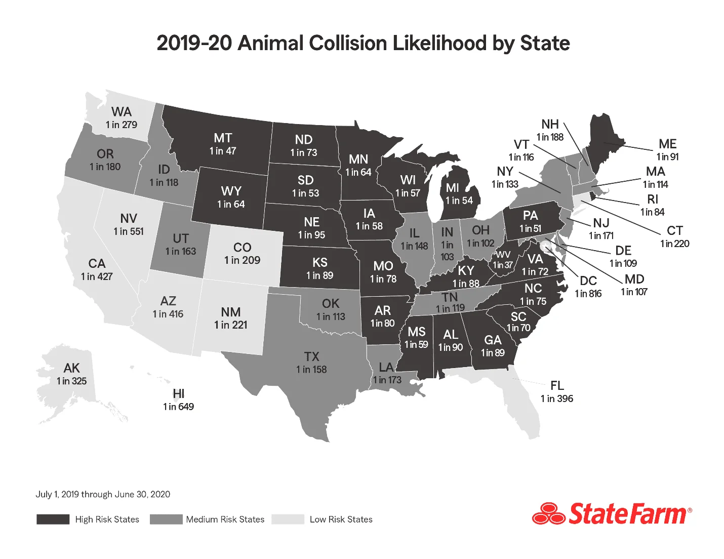

I hit one in a *low risk state*, where I had a 0.45% mean probability of hitting an animal. Those of you in a medium or high risk state would be wise to consider getting an aftermarket bumper.
Useless side note: I really wish they would produce these figures with probabilities instead of odds, the former of which are much more intuitive for the layman...
Map needs to be done by region or county in order to be meaningful. I guarantee you the odds of an animal strike in my area of Texas is MUCH higher than suggested (statewide).

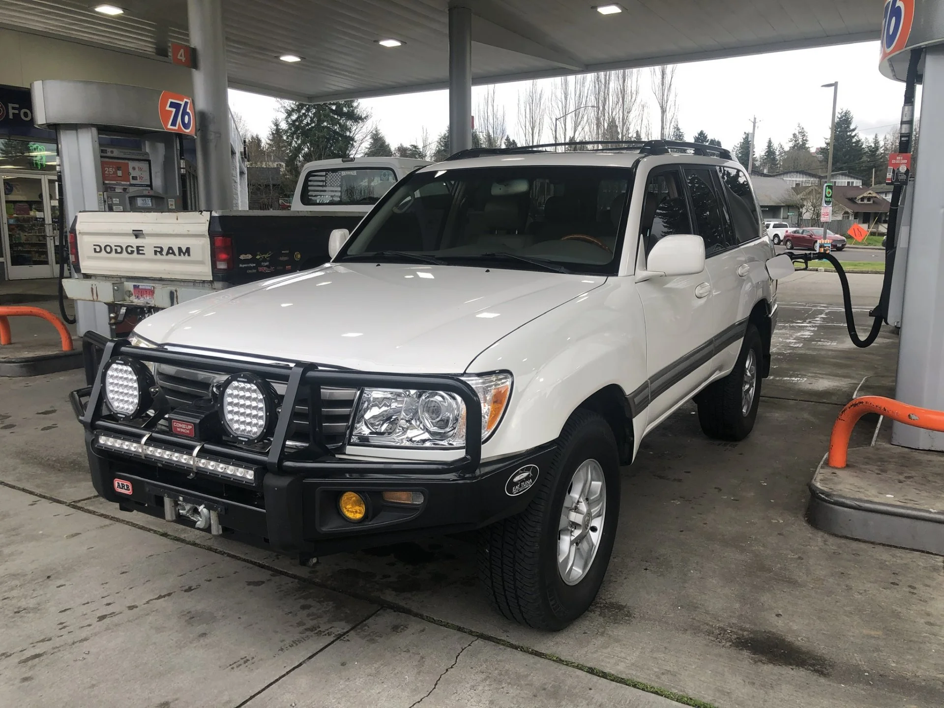

I have this ARB, probably circa 2017. Thinking about replacing with a Dissent to trim some weight. Anyone know what my ARB weighs? I'm guessing a lot more than the 65 or 55 lbs for the aluminum Dissent (original and low profile respectively).
HA! Does ARB even publish those numbers? How big is your winch and are you still wrapping the spool with cable or synthetic rope?
I put mine on myself. So not crazy heavy. Certainly under 100lbs. But there are frame caps and the steel plate below that add up, too.

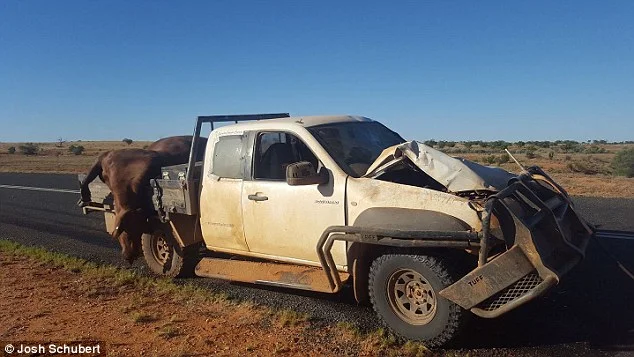

It is a not a LC100 but you get the idea -- the TUFF bar is a VERY heavy steel bar. The steer which end up in the tray of the vehicle is no lightweight. The driver survived but not the steer nor the vehicle.

I have not had the severe experience shown in the first pic above!

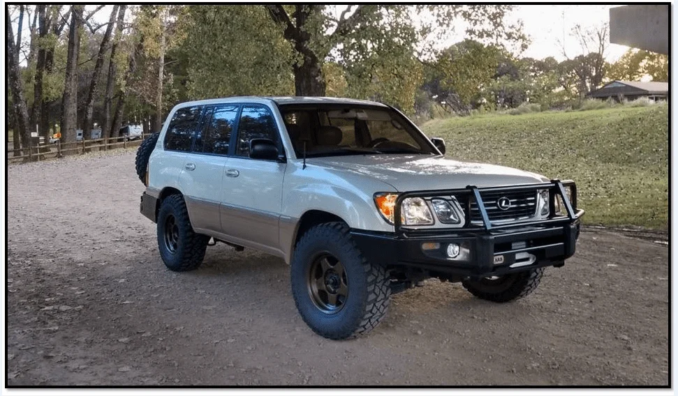

I do have the ARB Deluxe Bar for LC100 2002-2007 ARB Part Number 3413190 fitted to my vehicle as shown in the second pic above. This includes compatible mountings for the Safety Restraint System (SRS), alias airbags. Official ARB websites are unhelpful -- seem not to reveal weight information even to us locals!
Several times I have asked mechanics at Australian ARB dealer workshops what they think is the weight of this bar. The answers varied between 70 kilograms (154 pounds) and 80 kilograms (176 pounds) nett addition, after the plastic bumper and related attachments have been removed. This weight excludes winch, sidebars, sliders, lights, radio aerial etc.
The weight given by Amazon USA for the same item is 176 pounds (80 kilograms) – but maybe this is the shipping weight including packaging etc -- -- Amazon product ASIN B004LQGB4S
When I look around various Australian websites for different steel bullbars, the estimate of 80 kilograms (176 pounds) is most common – so that is the guesstimate I use when adding up the contributions to the allowed overall vehicle weight, called Gross Vehicle Mass (GVM) in Australia -- probably similar to Gross Vehicle Weight Rating (GVWR) in USA (?)
If someone on IH8MUD actually has weighed one of these things out of the box on bathroom scales, that would be really good factual information.

I liked the style of the ARB bar in the second pic above because the secondary bar which runs across the front below the lights creates a smaller gap, makes it a bit harder for an animal to fit through. So far, it has done the job.
Same here Flint. Down here in the ArkLaTex we have some big animals that get into the road.
