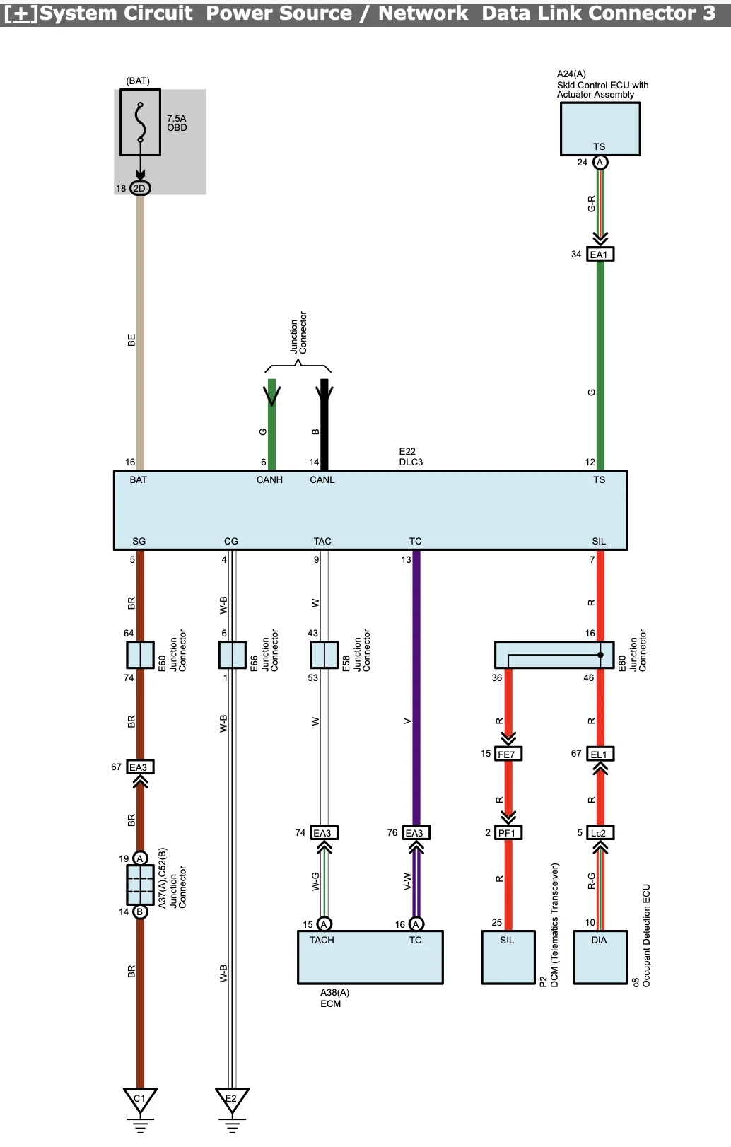

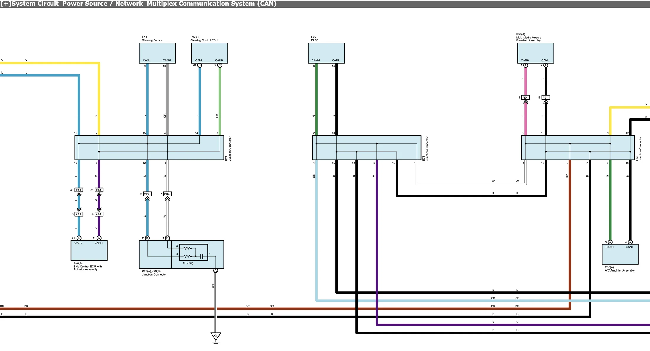

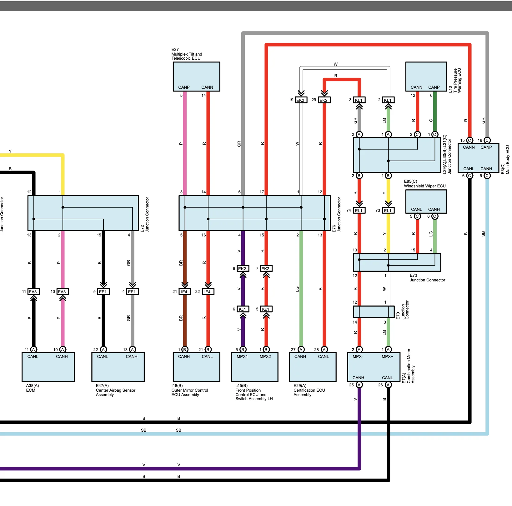

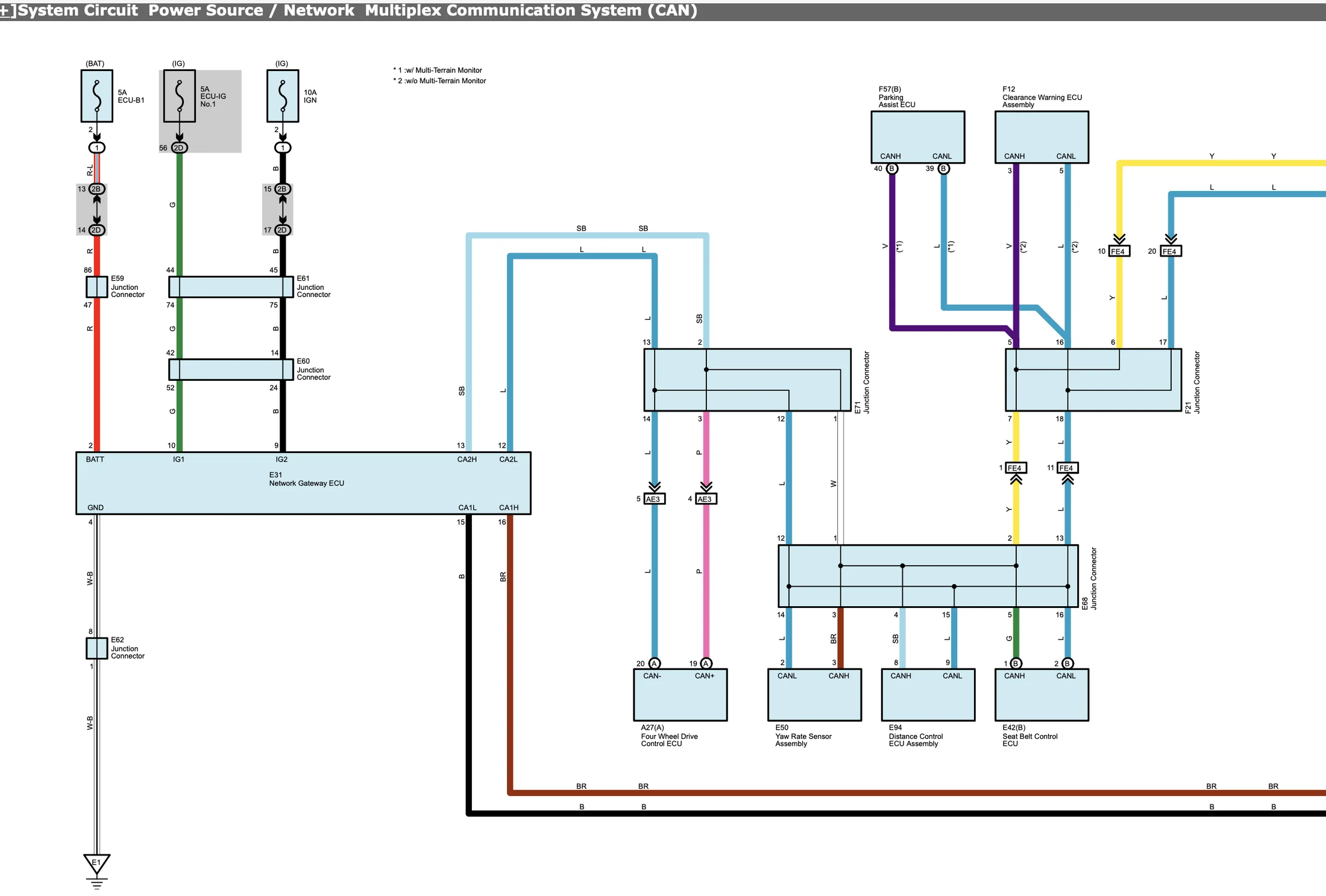

My EWDs are not loading for some reason. I suspect there is a gateway between the dash OBD port and the bus that has the immobilizer and the ECU on it. If there is a gateway it would probably ignore the OBD port error and go on with life (CAN has a bunch of fault tolerance capability and can tell nodes to shutup if their frames are corrupted).
If anyone has the EWD PDF's for the hardware below we can go deep into the drawings-
System Circuit > Power Source / Network > Multiplex Communication System (CAN LHD):
-Certification ECU
-DLC3
-ECM
-Main Body ECU
-Network gateway ECU
-No.2 Multiplex Network Body ECU

These are for a '13 cruiser. I'm sure there are wiring differences between this and at least 2016/2018, but whatever principles we come up with could be refined for other model years.
