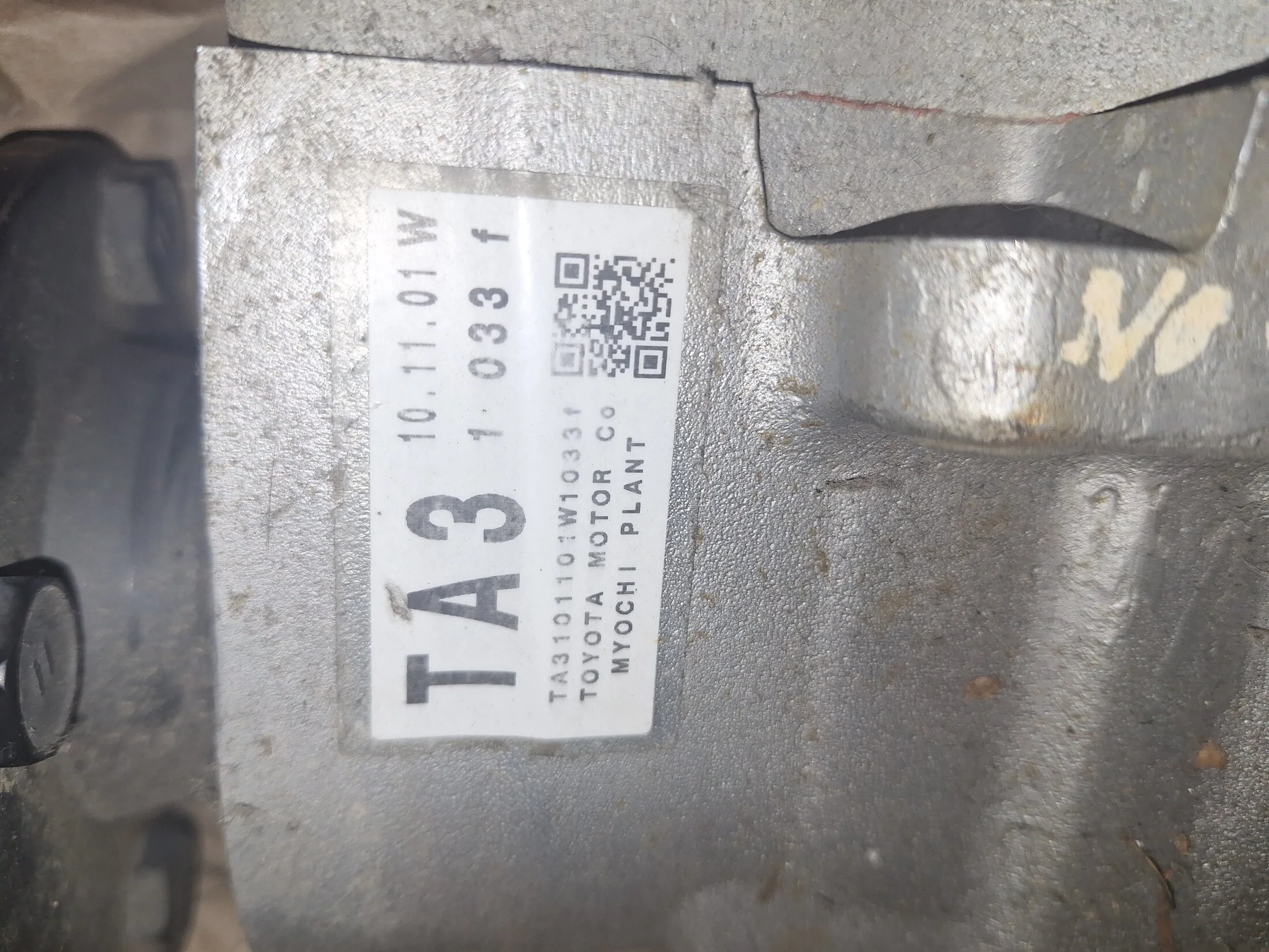

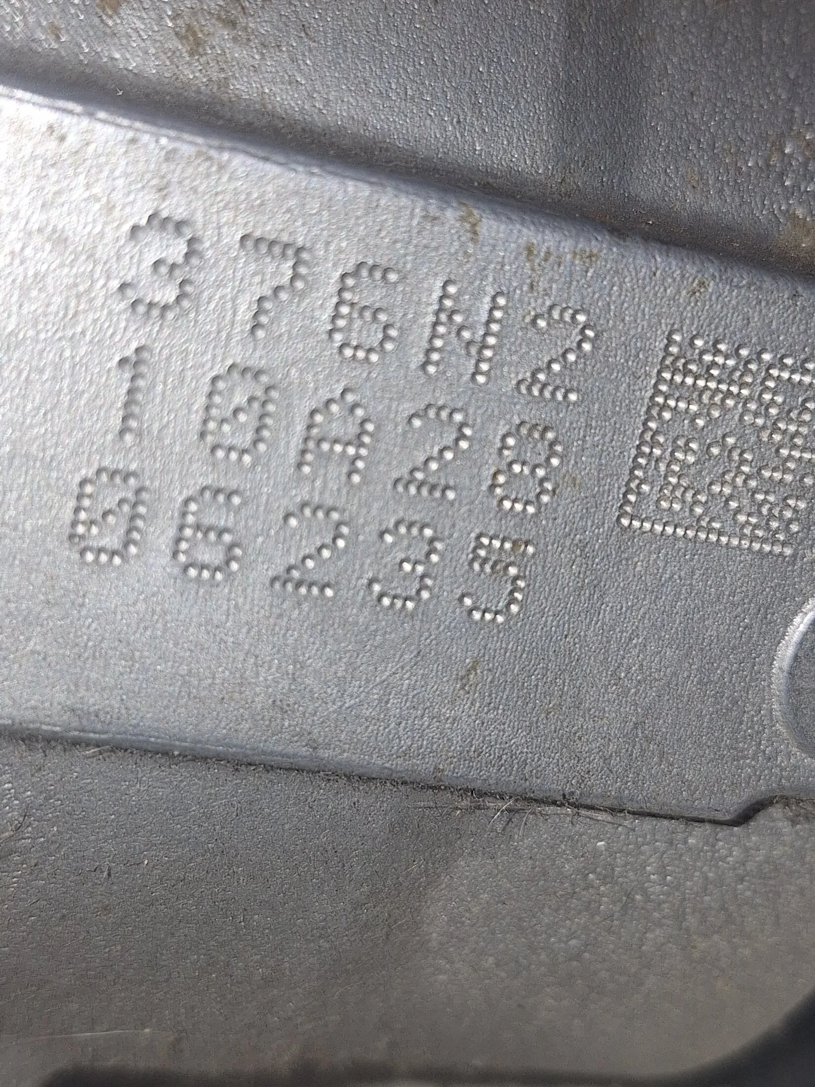

Have we determined how to check axle ratio? @bjowett
@bloc @linuxgod
Spin the CV and driveshaft and count and divide the rotations?
