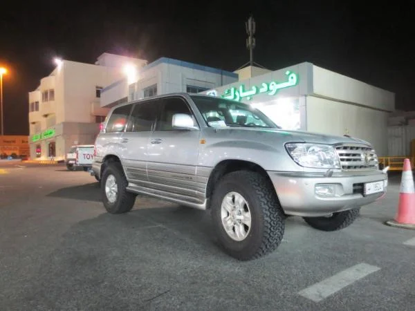

Old pic of truck to show stance with spacers and 315's
