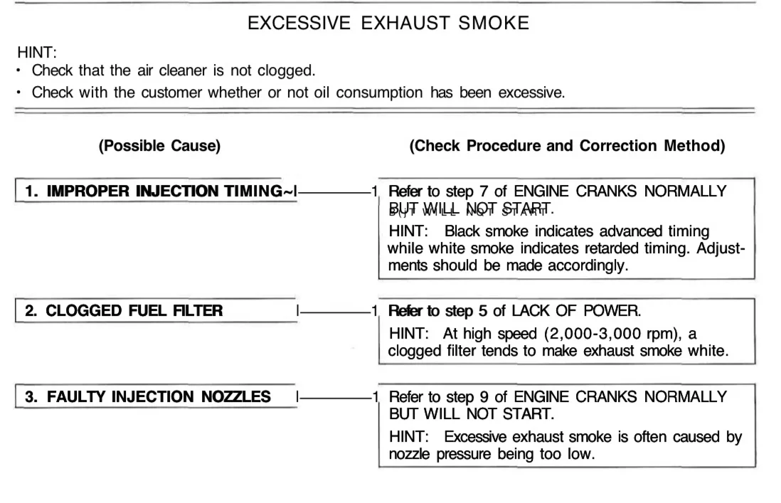

as per FSM about smoke
1. IMPROPER INJECTION TIMINGHINT: Black smoke indicates advanced timing while white smoke indicates retarded timing. Adjustments should be made accordingly
2. CLOGGED FUEL FILTER| 1 Refer to step 5 of LACK OF POWER.HINT: At high speed (2,000-3,000 rpm), a clogged filter tends to make exhaust smoke white.
3. FAULTY INJECTION NOZZLES| HINT: Excessive exhaust smoke is often caused by nozzle pressure being too low.
