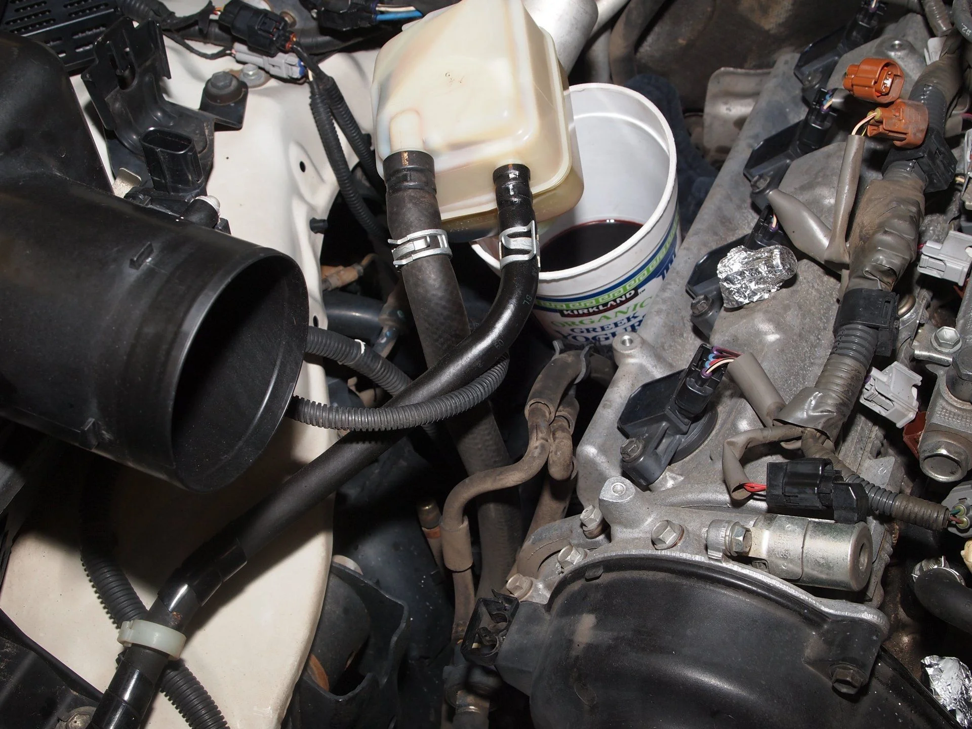

Power steering flushing, is one of the most overlooked fluid on any vehicle. I find flushing with M1 synthetic ATF regularly, can really quite Vane pump down, keeps system clean.
Best practice is to flush your power steering system and clean reservoir making sure screen in bottom is clean first. The screens sometimes are so clogged and bottom internal cavities so dirty, it just best to buy a new OEM reservoir. Save a lot of time.
Then if you install a new OEM Vane pump. You'll install into a clean system.
