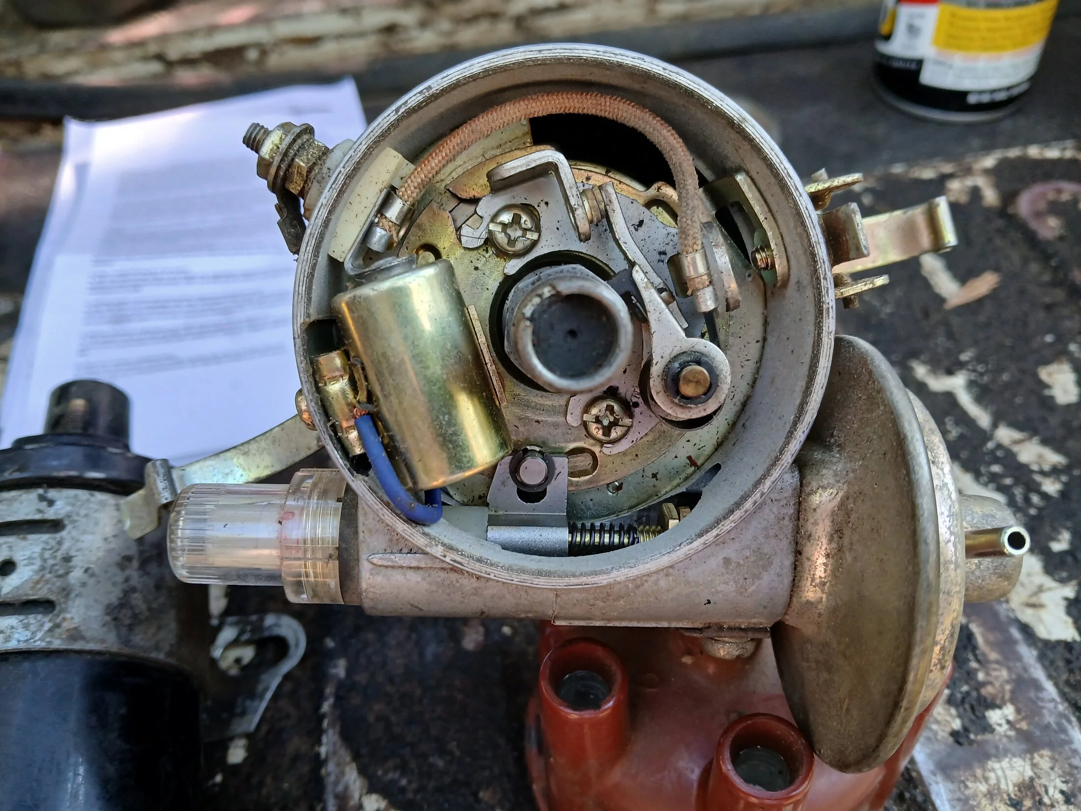

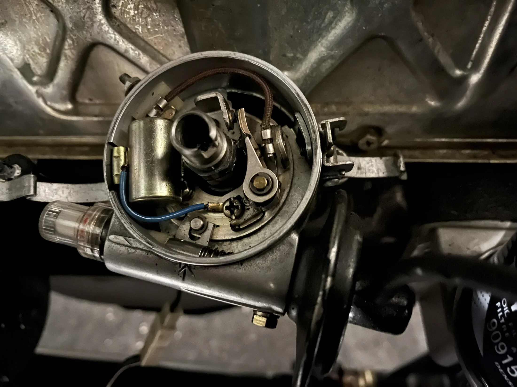

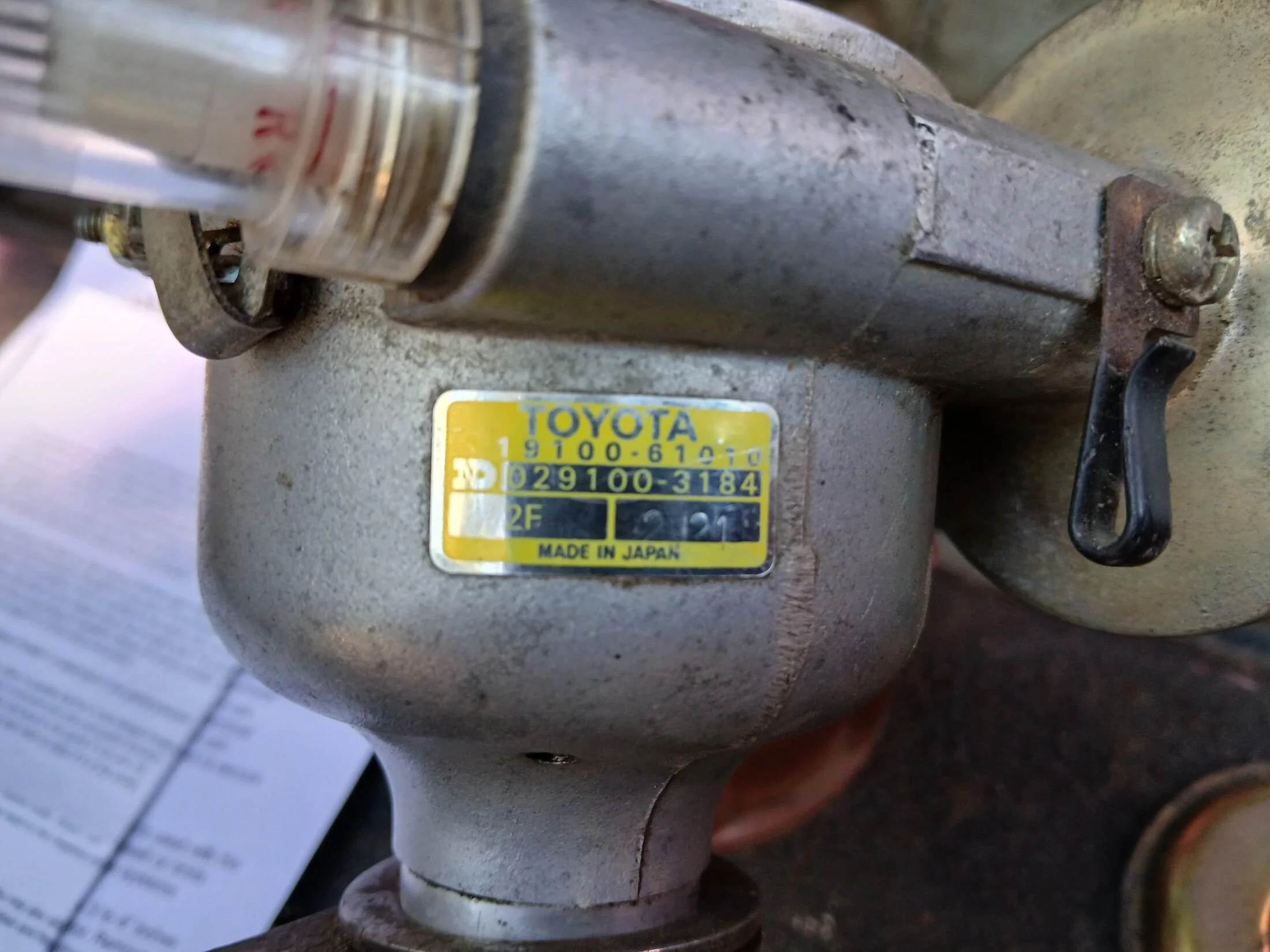

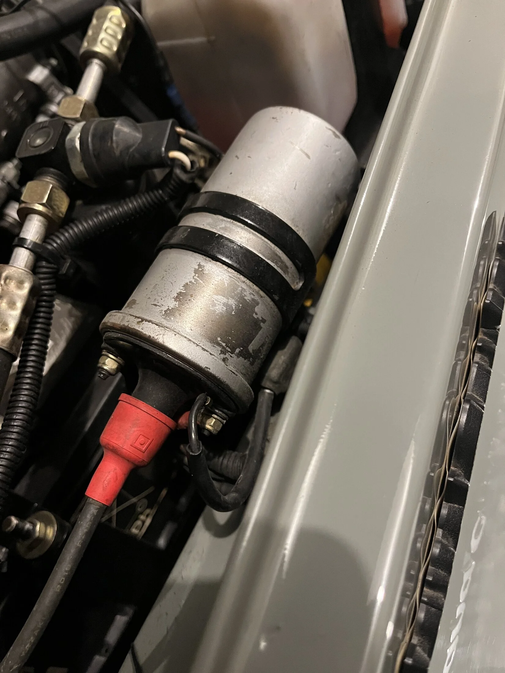

Hello all. I have a 77 FJ40 with what I believe to be a non us distributor. Looking to replace the points and potentially the coil. Anyone have guidance on what petronix parts I need to order. Here’s a couple pics of my current dizzy and coil. Thanks !

1665 and 91665 are for the E-'69 point's distributor (19100-61080).
1662 and 91662LS models are for the later 3F points distributor (19100-61180).
The above is to the best of my knowledge.
Edit: corrections
