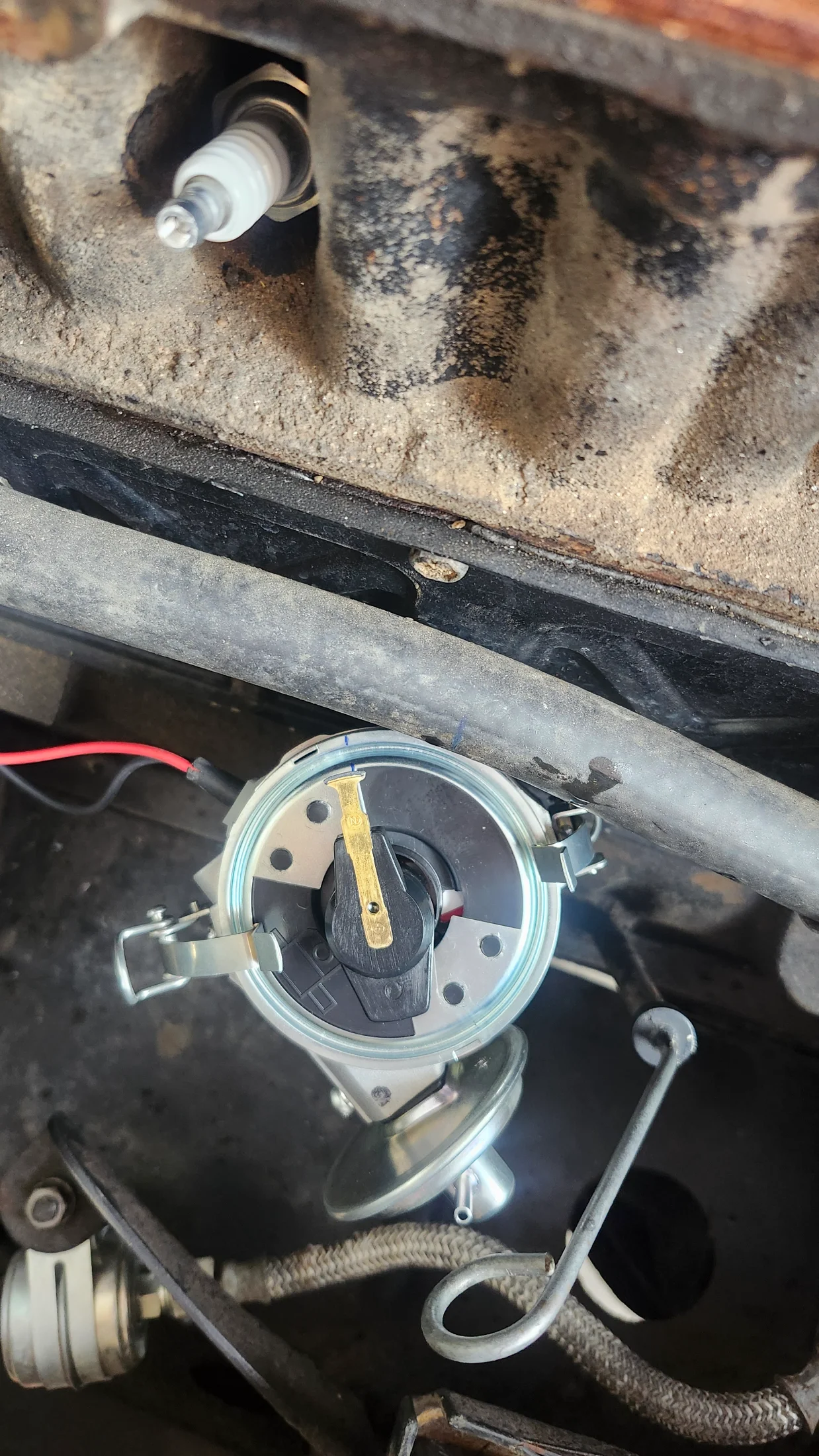

As I run back through some things, I've developed a question. I am at TDC as seen in one of the photos.
Another thread says, when reinstalling the dizzy from scratch, align the rotor to the #1 wire on the cap. That is the blue mark on the dizzy in the photo. And also align the mark and the rotor the #4 plug. If I do that the clamp won't allow me to advance. Cant I keep the rotor pointed to the #1 wire and put the dizzy in how ever I want so i have clearance to adjust? I cant think of or see a reason why not. Am I wrong?
Timing is in question which is why I came back here.
