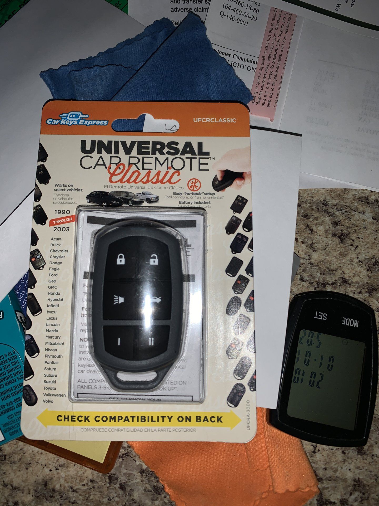

I just picked up a 97 LX and used the universal car remote classic. I used the LC code and now have 2 new remotes. Only the lock button works and toggles lock/unlock. The other 5 buttons don’t do anything.
