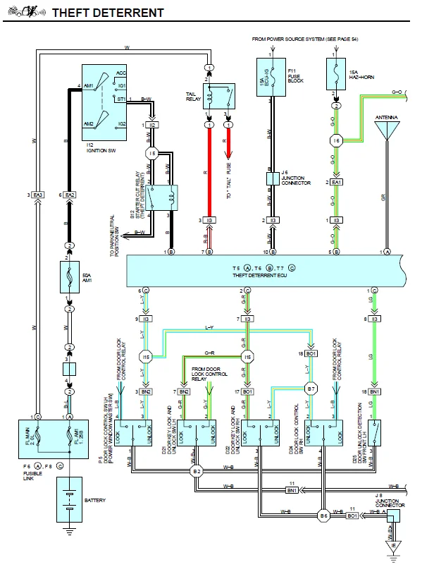

@60wag You DID! What wire is the antenna wire? I have been searching for this mod for years!!!
Can you help me out?
@60wag and @TomH Thanks for the replies. I have a TVSS system, not RS3000. No excuses, but it has been several years since I've worked on it. Sorry for the confusion.
If anyone knows the antenna wire color for the TVSS system that would be awesome!!
Try the EWD
@Malleus
Good tip. I can't find anything in there. It has been ~10 yrs since needing a new FOB. That, was the last time I traveled down this path. I'm sure it's out there.
You'll have to use the LX450 EWD. The Land Cruiser alarm was port installed and isn't in the EWD.
No guarantee it's there; I haven't looked for it. But if it exists, it's in there and not the Land Cruiser EWD.
From the LX450 EWD. Not sure if this is the TVSS.
