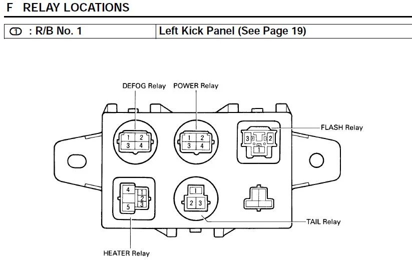

The one circled in red... Tail relay?
btw, why does the one under the one circled in red look like it's not plugged into the circuit board(white plastic board) 🤔

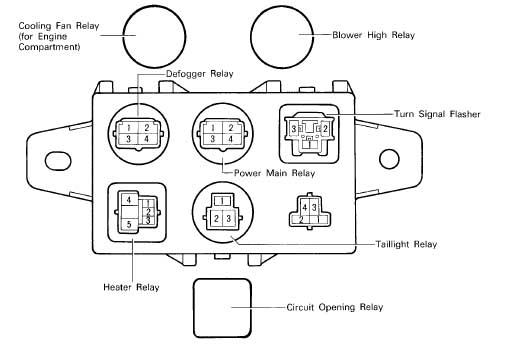

The circled relay is the tail lamp relay.
The one below that is the circuit opening relay which runs the fuel pump in conjunction with the fuel pump relay. It hangs off the bottom of the relay block, and for some reason Toyota did not see fit to include that relay in the relay block picture in the EWD.
However it is shown in the EWD of earlier years.
From the 1996 EWD:
From the 1991 EWD:
From the 1996 EWD:
From the 1991 EWD:
Very weird they did that. So now I'm just wondering why that relay was the one fast clicking.
