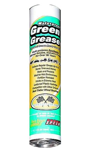

I use moly in the shafts and green in the u-joints

Green grease in all 6 zerks, every 3000 miles. Took carr of my clunk problem
Started using this years ago on my Tacoma. No clunks or noise from the drive shaft or u-joints. No clunks on my old LC.
It works with me being submerged under water often.
BEWARE -- If you get this on your clothes, it is hard to wash out.
