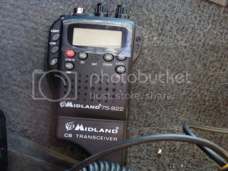

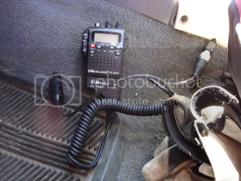

The nice thing about it is that if you have the Midland 75-822, which the unit IS the push to talk, you can stash it away and just have a small thing to use.
Just a theory so far. Will let you know after testing.....
