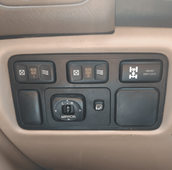

Same here. They post a story about your build online if you like.
Then you can add an extra button for the front eLocker..
