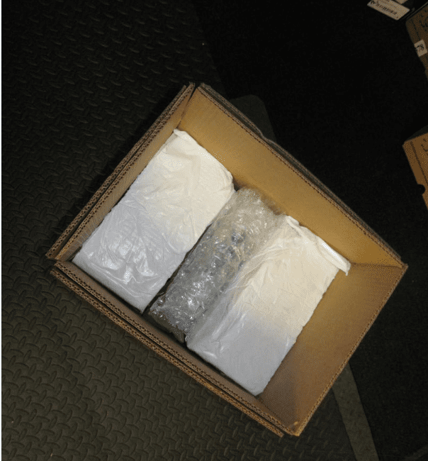

I did most of my own work except for packing up the 3rd member and sending it out to Zuk in AZ for him to install the Harrop. Zuk returned the upgraded differential and I installed it. We shipped the 3rd member back and forth in a double packed box with expandable foam. Zuk provides very detailed instructions for packing and shipping 3rd members. Based on comments from here and other Toyota sites, I can safely say that Zuk is one of the best diff builders in the country.

Here's the packed 3rd member from shipping.
