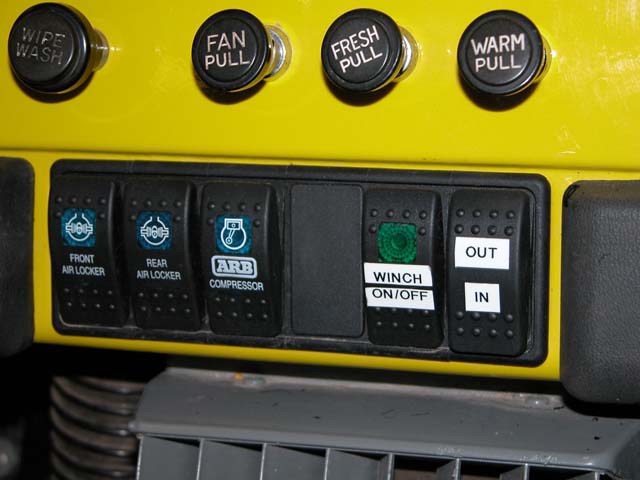

Here are the switches installed into a 12/82 40 series, in a fabricated bracket:
I remember seeing a thread about mounting switches where your ashtray is located. They removed the ash tray, made a block-off plate, mounted the switches to it. If you do not need an ashtray, it is a good way to go and it looked really clean.
Here is a pic of the ash tray plate. Pretty trick I have one in mine. Proffitts sells them... Not sure how much. Also try 12VoltGuy.com
X2 That is exactly what I was gonna say! Proffitt's makes the ashtray cover for switches and 12voltguy.com or seabass44 on here (i think) makes a ton of really cool custom switches!
This setup uses the ARB bracket.
your gonna need that ashtray for something besides switches. use something like angle iron or angle aluminum or angle plastic( i used a hacked up 3x5 reciepe card holder)and use the bracket with 2 bolts that holds your steering column on the bottom edge of the dash board. that way you dont cut any new holes or loose your ashtray. Just sandwich that thing in there and put it off to the one side of the steering column. ill try to get you some pics.
