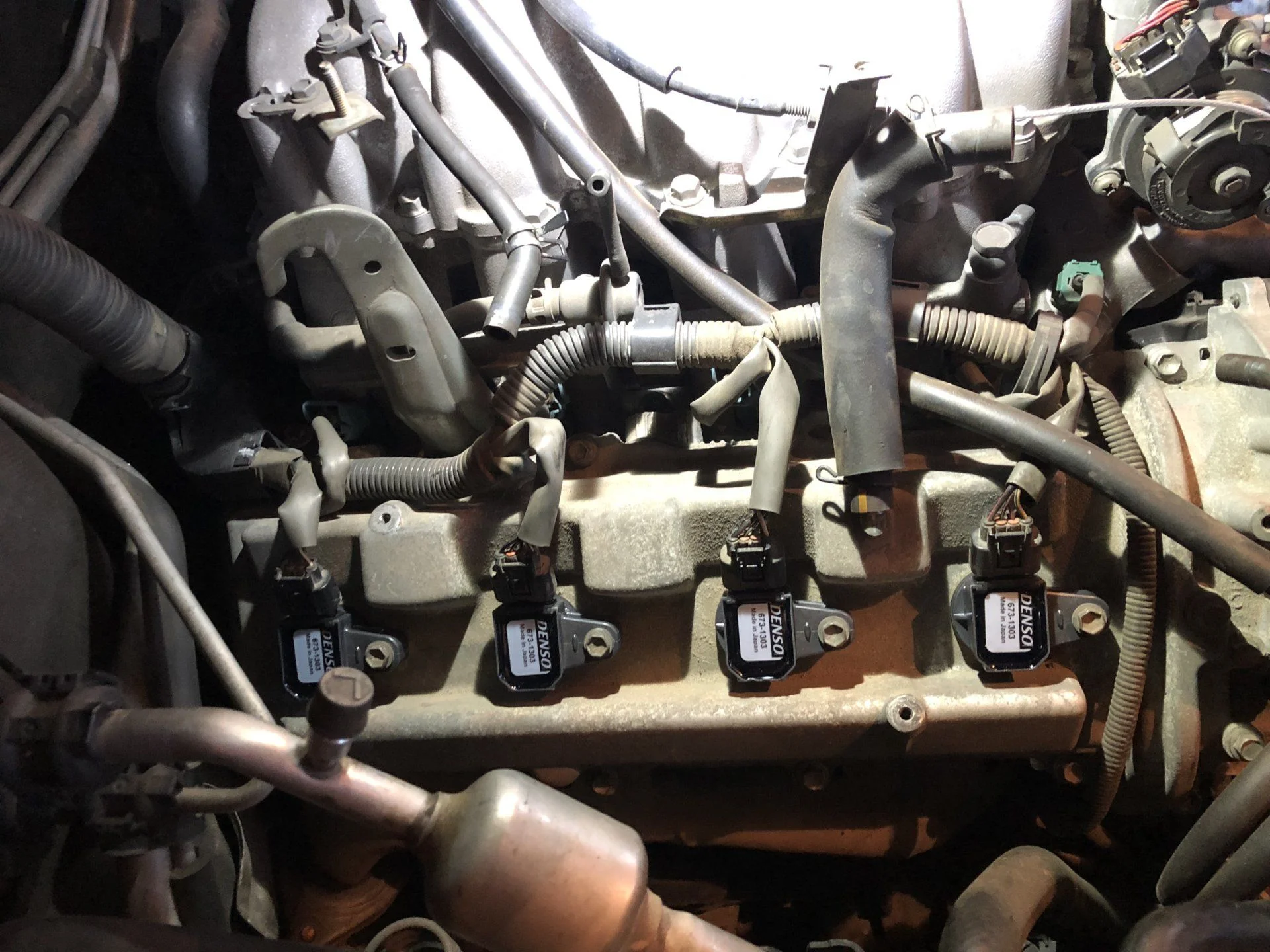

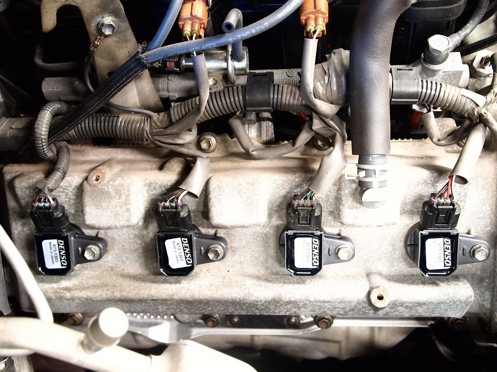

Test drive with 8 new Denso coils in:
I took out on test drive in the heat of the day and monitored fuel trims, once I had the 8 new Denso coils in.
I noticed better balance between bank 1 and bank 2 fuel trims. I notice idle just a little steadier, most noticeable while stopped at light in "D". Also notice it started a little pepier. Also has just a little smoother acceleration onto HWY. These are just incremental changes only few would even notice as I do.
Feeling and seeing the difference, albeit small, has convinced me old coils even though not dead or not even misfiring do loose some spark and fire unevenly.

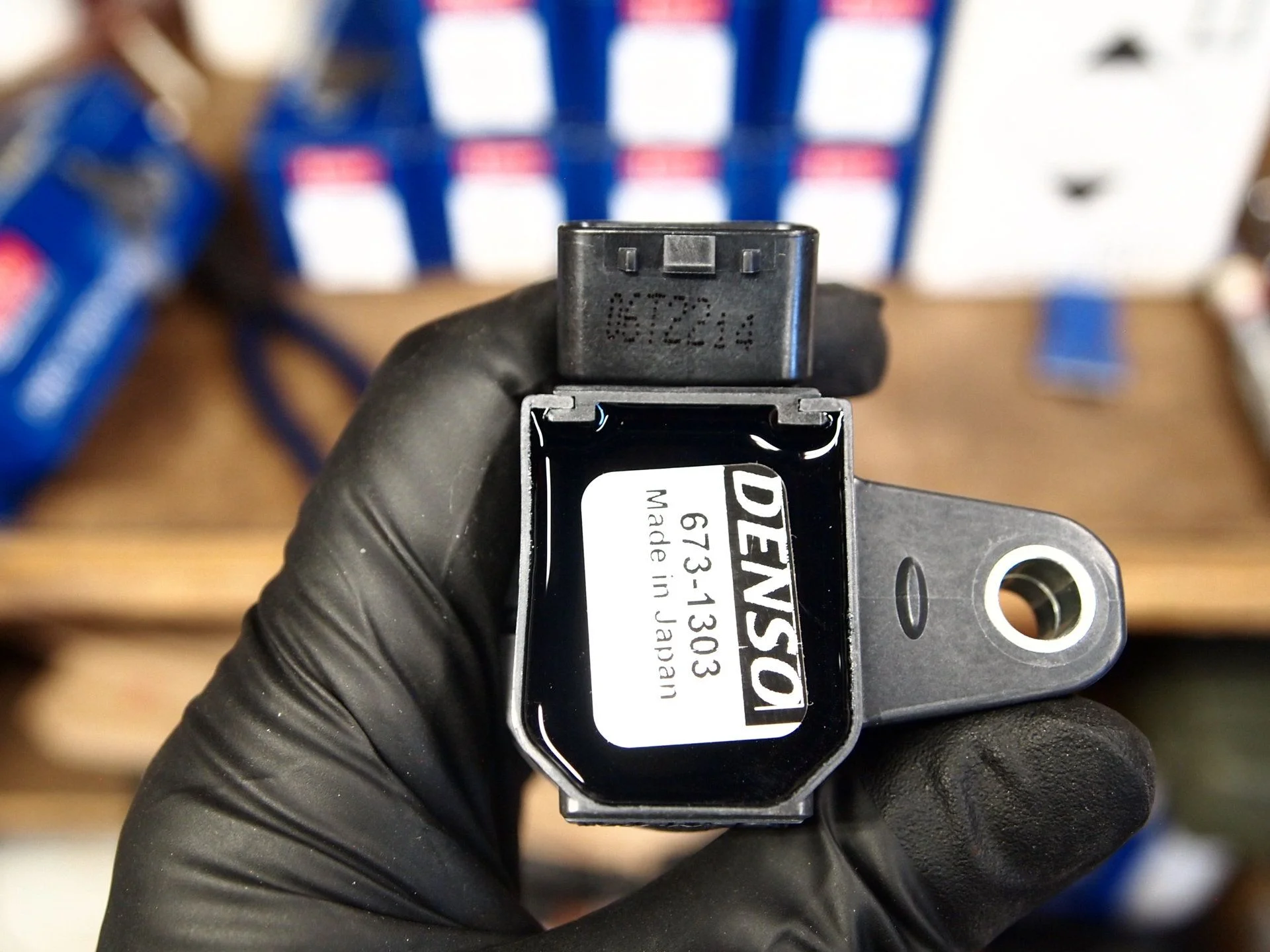

Denso 673-1303 were shipped to me and inslatted.

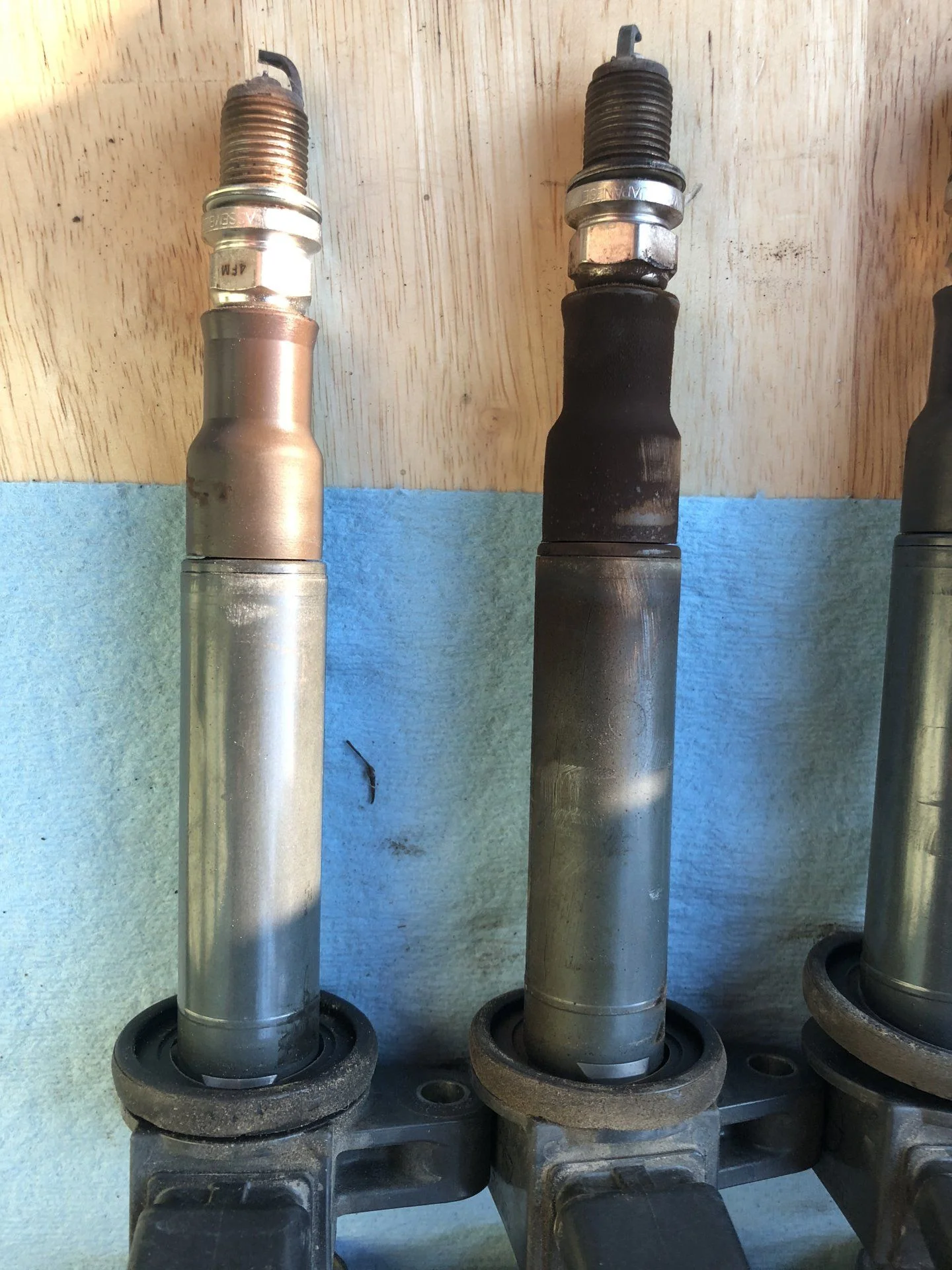

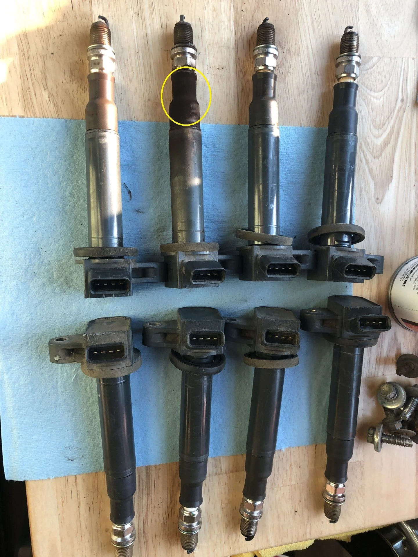

Anyone have any idea what was going on with these two coils/plugs? They are remarkably more brown/crusty. They are the front two cylinders drivers side.
Is that something to watch for with the new coils?
Circled looks like carbon coating. Could have a leak, like cracked porcelain. But likely, just so loose, it was not sealing when engine warmed up.
I'm thinking cracked porcelain. I'd say loose plug (which is common), but I don't see crabon on chrome nut part.

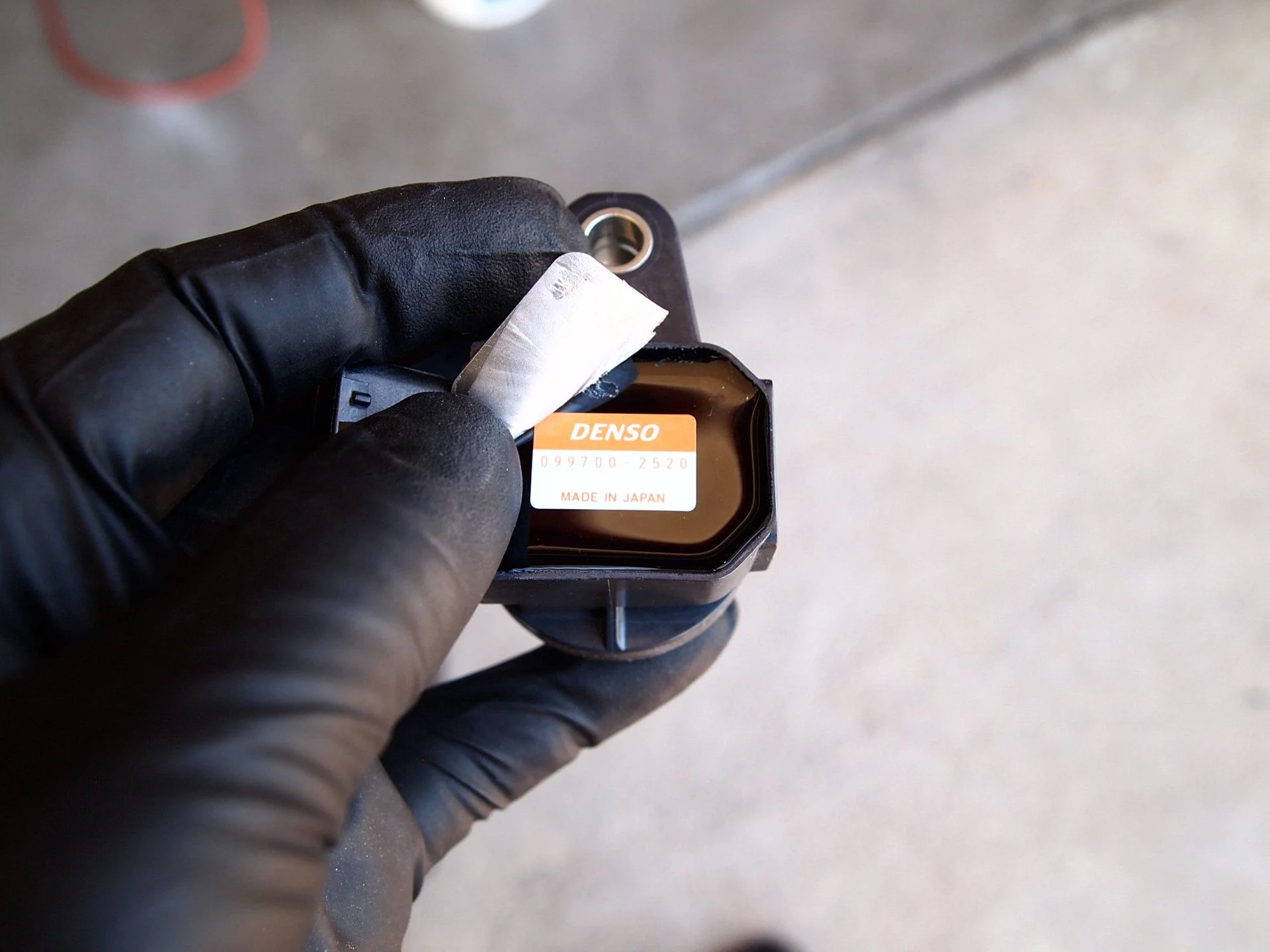

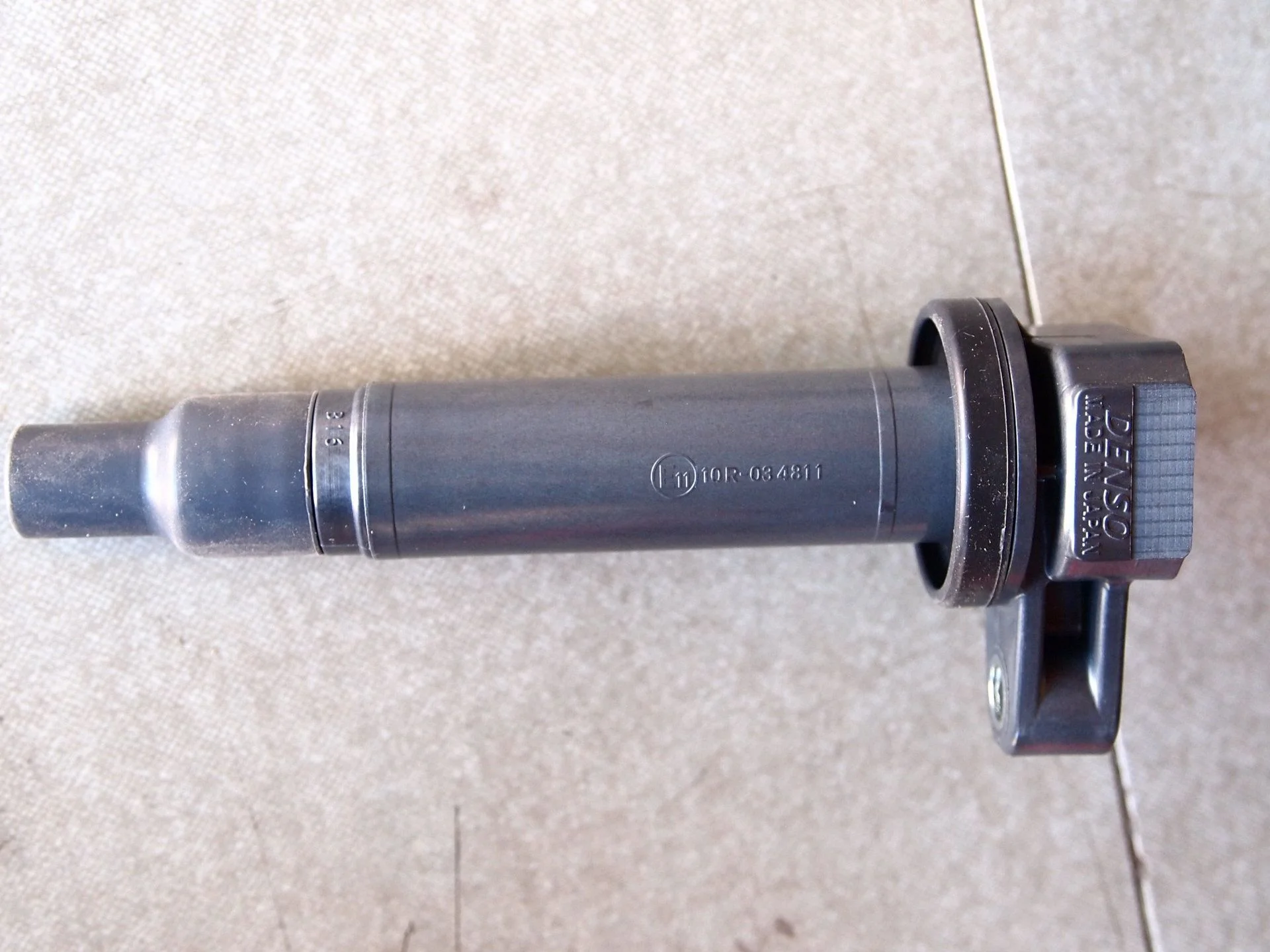

Let me add a note here about the NONE Toyota Dealer Denso coils above:
Note: You may have seen I peeled back the part number sticker. It revealed a differ Denso PN. I've not found a cross reference (not looked much) on that revealed part number, which was not in list of numbers I had for the 100 series (I don't have all). So I can't say for sure they're Toyota approve power curve/output or whatever. But they did look like real Denso's and seem to work well. Also my buyer of The Unicorn send me these coils to me from different sources. They all looked the same, but I did not pull sticker back to confirm hidden PN's to see if all the same.
Also I've talked with my Toyota parts guy in the past on why we've different PN for different years of the 100 series and why each different one has superseded part numbers. Bottom-line "we don't know". We can only make assumption.
I'm more comfortable paying a high price at Toyota. But sometimes it's not up to me of which are used.
