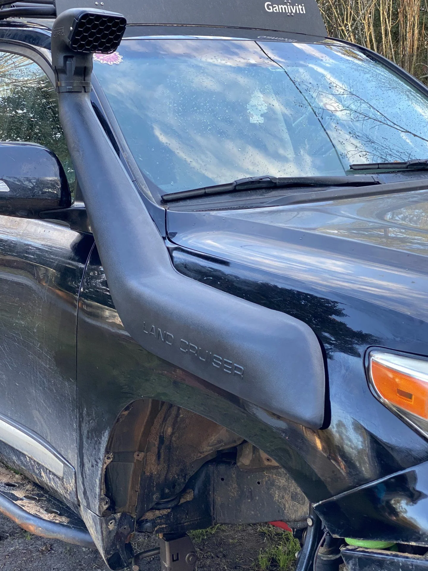

That’s why I have this now:
You never really know....
Ooof, sorry to hear about that. Looks like you have it taken care of now with the snorkel.
Would be interesting to see how the splash guards are arranged around the aftermarket bull bar and wheel well. I'd bet with as much cut-out and some speed, it may have actually funneled water into the fender right where the air intake is located. A stock setup may actually help with a better bow wave in this regard.
