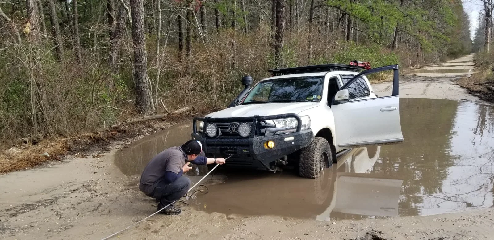

I too, have sunk my LC in the pine Barrens in NJ
Wow. There must be a serious mud hole beneath the water. From here that doesn’t look like that bad of a hole.
It brings up a question I’ve thought about. Usually when I approach a hole like that, the middle may be a quagmire while either side might be a little more solid. So the question is, if you have to go deeper on one side, which is best? Seems like the air intake is on the passenger but all the electrical is on the drivers side.
Where I’m from, in swampy South Georgia, easing into a mud hole slow is how you get stuck. ;)
But this was in northern Ark…
I’m from LA where it’s also pretty swampy, and barreling into a mudhole of unknown provenance is something i learned not to do as a teenager. Cool video tho. 🙂
