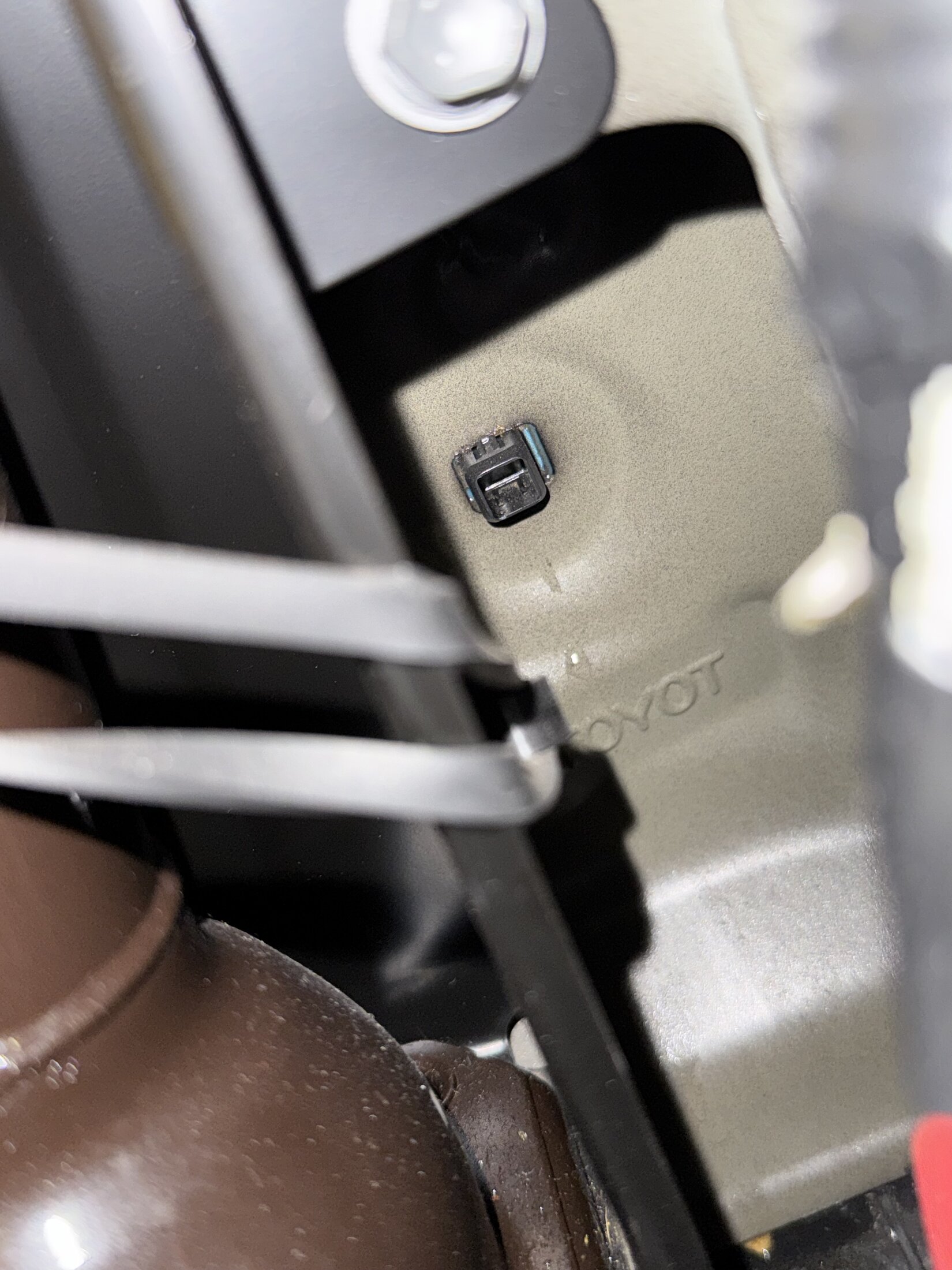

I found one small source of water leaking. Passenger side rear cover that exposes the jack, looks like the clips that hold the bumper in are allowing water. Crazy…. View attachment 3794036
Good find. IIRC those do have a small black foam gasket on them when new.

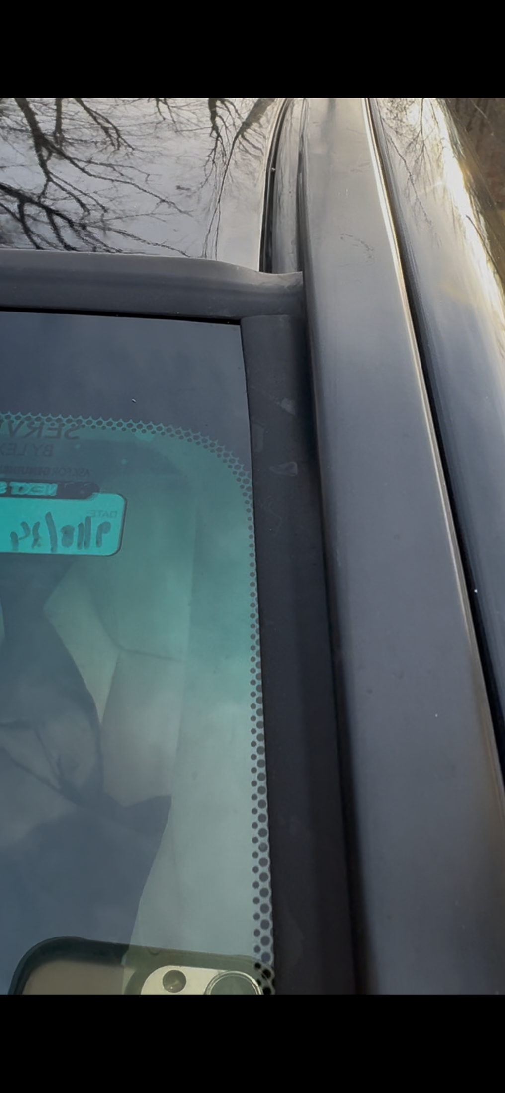

I added some weather stripping all around the windshield and cowl today in hopes it’ll solve the front leaking. I noticed that it was actually my driver side floor mat that’s wet and I’m convinced whomever replaced the windshield did a sloppy job because both driver and passenger side trim pieces have gaps and so does the cowl in misc places. This has to be my issue so by adding the weather stripping it sealed all the gaps so fingers crossed it works. It looks OEMish.
FYI when I got my rig it had round trim like that across the top of the windshield, and that shape caused a whistle at freeway speeds.
Also continue to monitor closely for water. The way the panel is installed, trim around the outside edge might not seal things.
The weather stripping totally fixed my issue and totally whistles at highway speeds if I open the windows. Thanks for your help!
