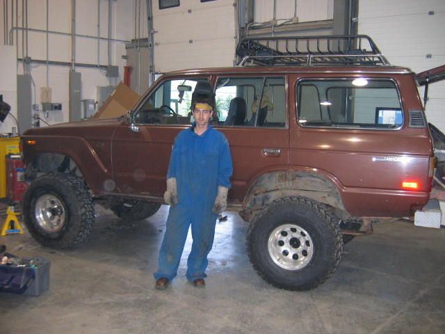

how did you raise her so much??
Holy smokes, thats an old post, the 60 has passed now, but that has a spring over axle lift and high steer arms to clear the leaves in the front.. My buddy in the picture did some welding I think. I went to parabolic leaves in the front and later 16x10 DC-1 wheels and 39.5" iroks.

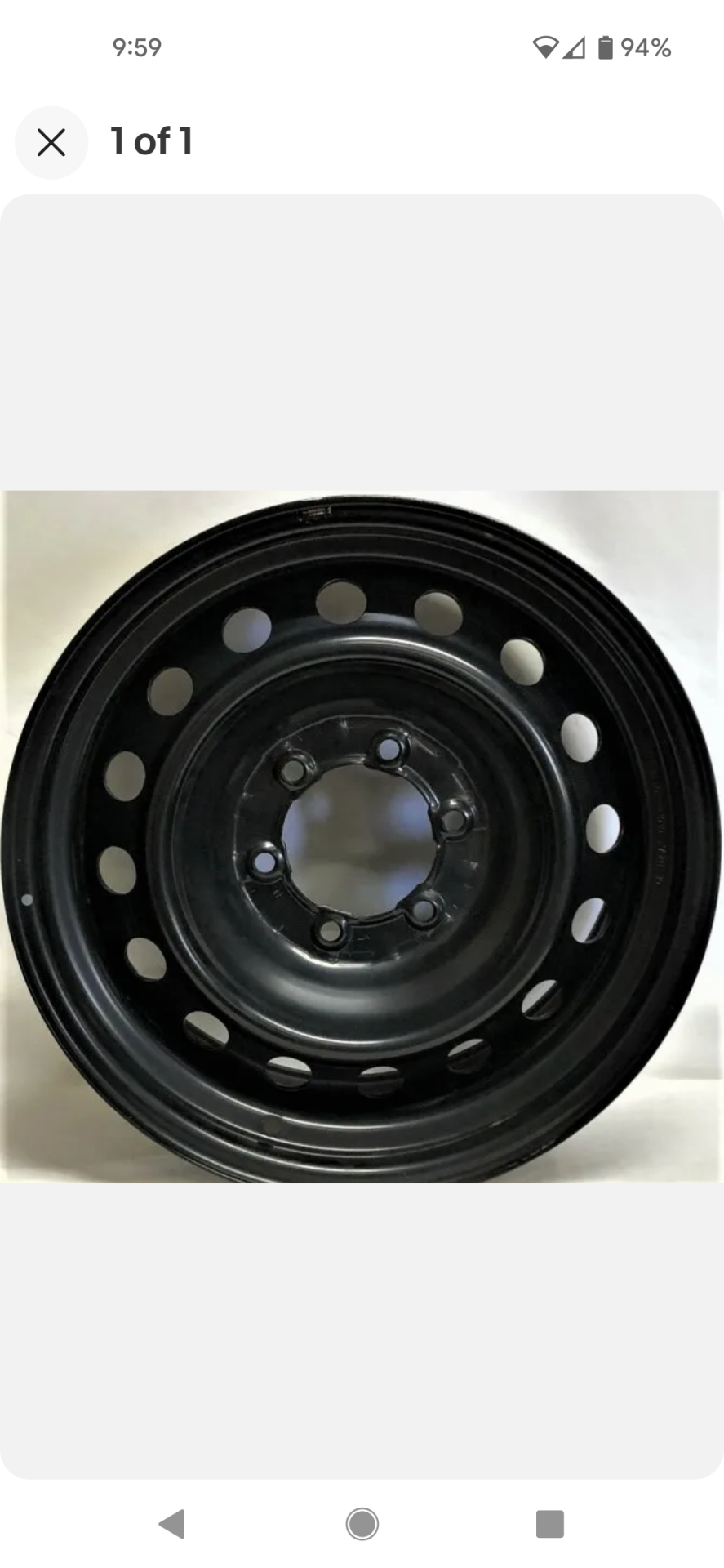

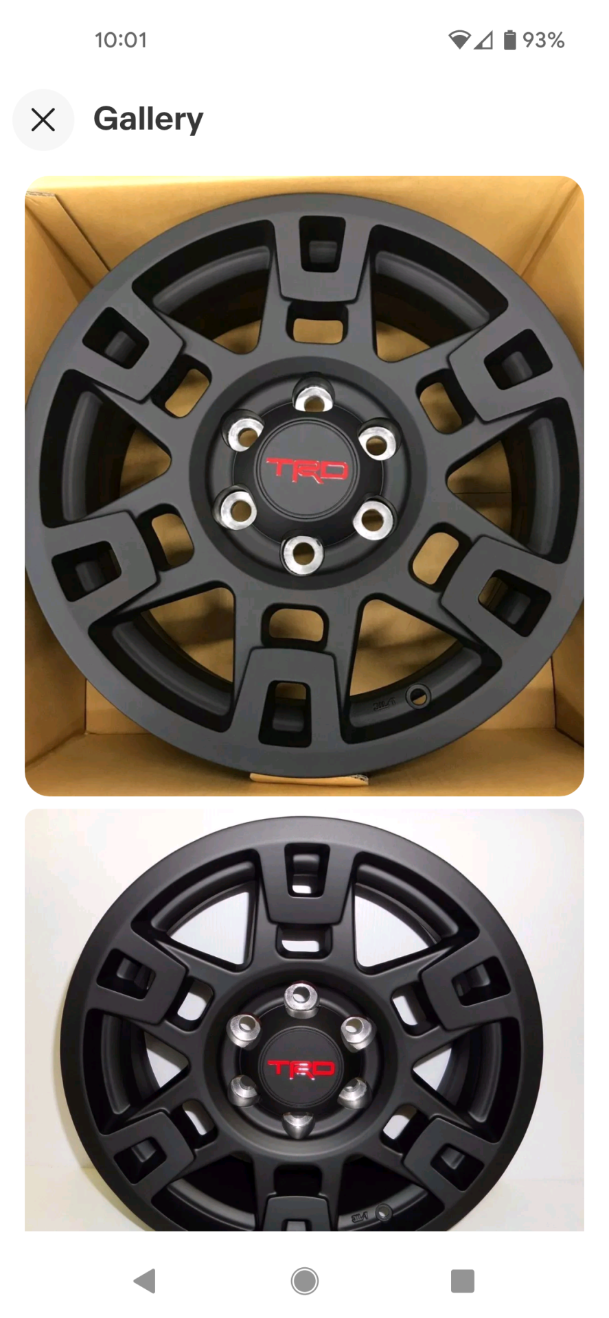

I almost posted this in the steel wheel thread, but this is just as good a place as both are not steel. Does anyone know the specifications/differences between these two wheels? Both are 17" and 6 lug, but width , backspacing etc? I was thinking they might be the same?
4runner TRD pro and the FJ cruiser steel. I already know they don't fit without spacers unless you have done other mods.

I have the steel one and they fit with a 1.25" spacer or bigger. No big deal in my opinion.

The offsets are different. -4mm for the TRD Pro (SEMA) 4Runner wheel vs. +14/15mm for the steel wheel. That’s why you need spacers with the FJ Cruiser steel wheel.
The TRD wheels fit great on a stock truck. My one cruiser/mud claim to is I was the first one to run them on completely stock axles. 😂 A number have people have documented success with them.
Torfab had been previously but he had an 80 series rear axle and brake/hub mods on the front.
Gunmetal grey right? Looks nice. If the online calc is right, the backspace of both wheels is 1" different! The TRD are 7" wide and the FJ 7.5"

the TRDs fit without spacers or mods as I mentioned in my thread!

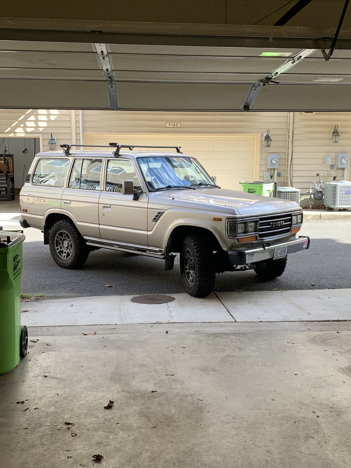

Picked up some SCS Gen 5 wheels in gloss bronze over the weekend. 17x8.5 4.30 BS -10 offset. Was originally wanting to order a set of Bradley Vs but the shipping just gets more and more expensive every month from Japan. As of today shipping for 5 wheels from Japan is a solid $650 for the slowest option
Picked up some 1.25 inch wheel spacers just in case, but after reading the thread, the 17 inch wheels dont seem to have the same issues the 15s do. Im really hoping i dont need the spacers. I guess once they get in ill post up if they fit or not. Thinking the tire is going to hit somewhere at very least.
The wheels will be going on a set of 285/75/17 Geolander 003 MTs since they dont make Cooper STT Pros or any Cooper MT in this size. Really hoping the 34s will fit on my 2.5 inch lift with the ome AALs.

With those measurements I think you're likely to hit the relay rod at or near full lock (without spacers). I tried running 17s with similar backspacing and that's what happened to me. Nice wheels though - really like that JDM look.
Crap. Well at least I got some spacers just in case. If it’s at full lock I’m wondering if I could get away with just some .5 inch spacers instead of the 1.25s I got.
Honestly I’ve got 80 series axles that I’m eventually going to run these wheels on, so I’m just kinda trying to make it work until then. Scs actually makes sizes specifically for our trucks with 3.5 backspace but they would stick out quite far once I swapped the axles over :/
