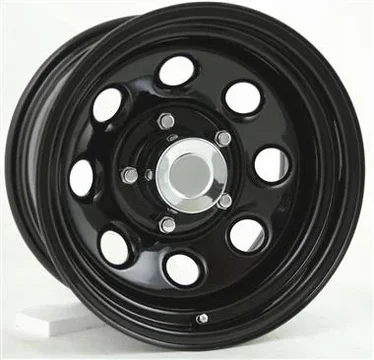

I have finally settled on a wheel. Finding a fairly plain, non-"Bling" wheel is alot harder than you'd think. Most of them are overdone, and pretty ostentacious. I have to thank Desert Rats guy for spending time on the phone, they had a really good deal on a rim they discontinued, but I got there too late.
4WheelParts finally got me a wheel. 17x9 with 4" Backspace. Any more backspace and there will be too much tire rub up inside the wheelwell. ProComp Series 98 17X9 4_BS.webp
What I did find out which is valuable to all older landcruisers, 40's, 60's, is that this style of wheel can be ordered with many different backspacings. I did not want to deal with backspacers. I also learned, and I'm open to being corrected if someone is more knowledgable, but 15" tires have lighter load ratings. With a 17" tire I can get a load rating of 'E' with 10 ply side walls. The Toyo Open Country M/T 285/75R17 I am going to use are a load E, 10 ply tire with a possible max 80 psi. With a heavier diesel, loaded for travel, pulling a trailer with a quad/canoe, this is important to me.
These wheels were also fairly inexpensive at $98, free shipping to anywhere in the US. Couldn't be better. Pro Comp Series 98
Thanks to all you guys for your input, it all helped in my decision.

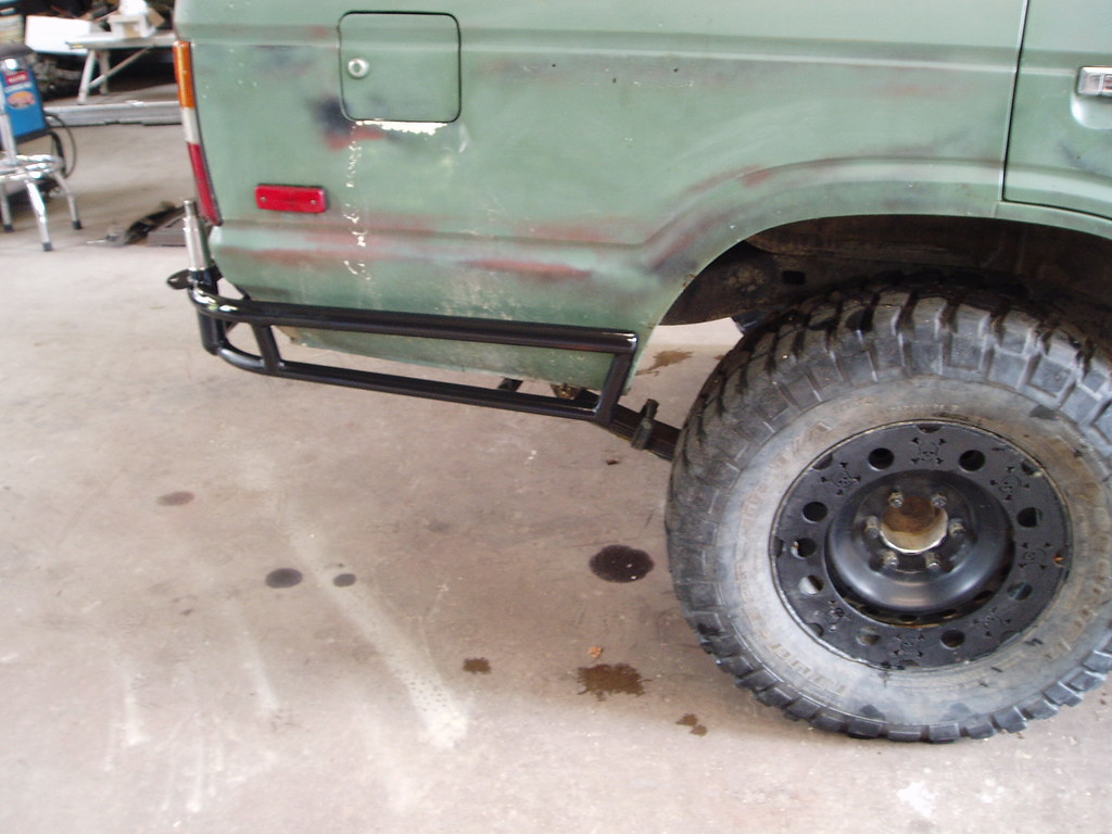

To NCFJ: I noticed stock bumper on one pic, aftermarket tube steel tire pivot and side protector. What kind of rear bumper would that be and could you post a complete pic of the aftermarket bumper? I will be fabricating my own bumper for the rear and am collecting ideas. Thnks J
