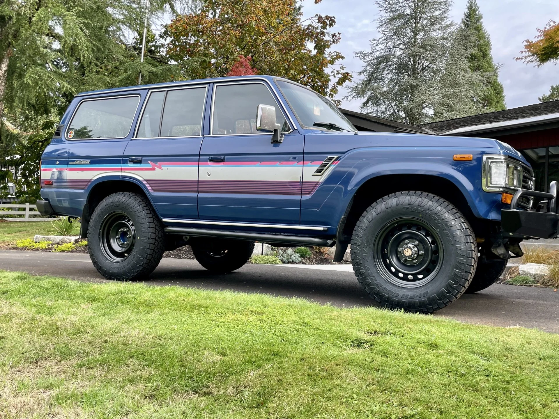

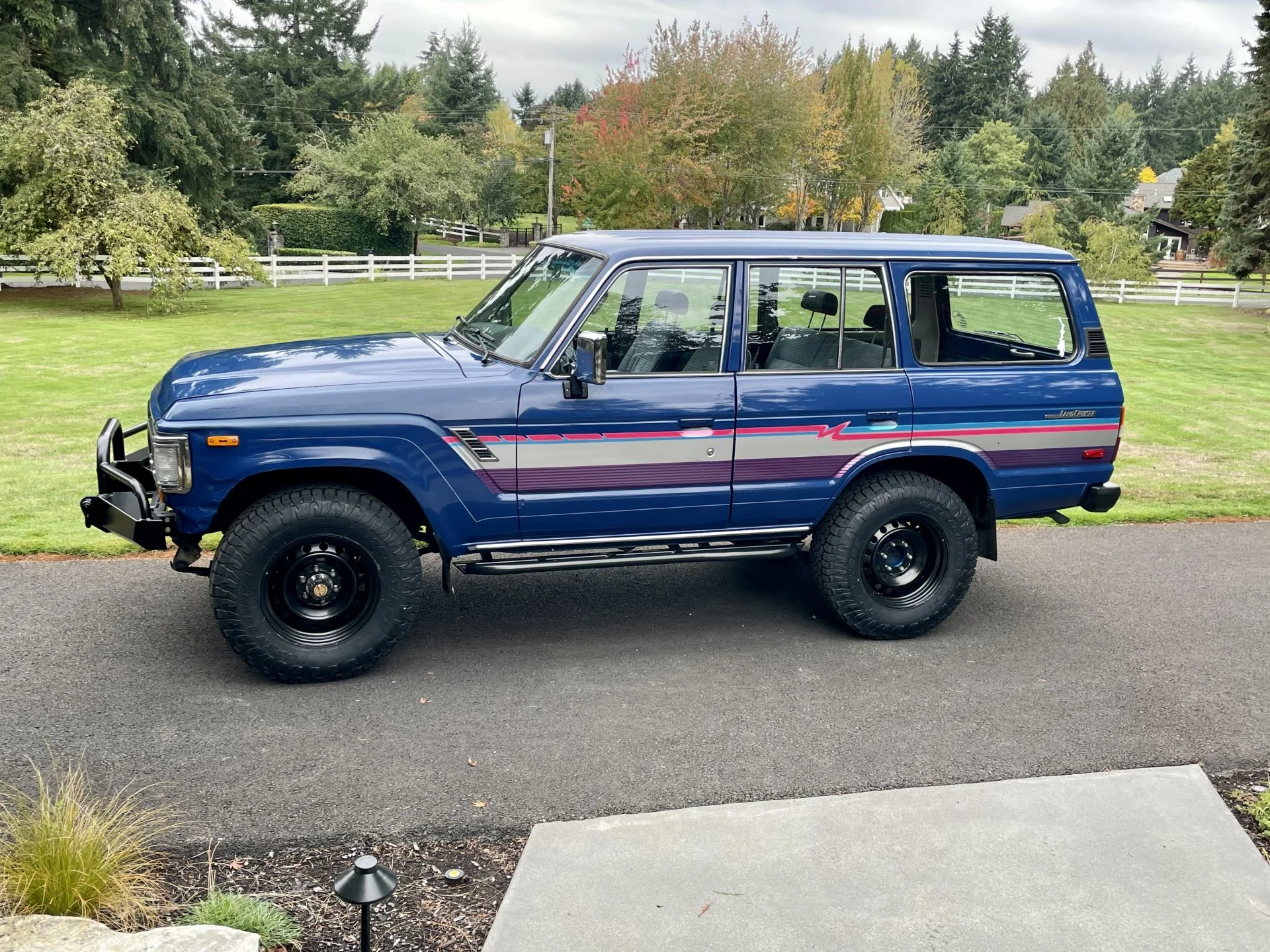

Yokohama GEOLANDAR MT G003 all_ Season Radial Tire-LT255/75R17 111Q 6-ply (aprox 32")​
and 17" TRDs. No spacers needed!!!

I used FJ cruiser (2007-2014) steel rims from Japan. They are 17 x 7.5. They do require a 1.25” spacer which I got from Spydertrax. I got the FJ40 ones as they don’t technically list an FJ60. But the FJ40’s work same size. The tire I went with is a 255/80/17 which is a 33.2 x 10 size. I am really happy with the look and the setup. I think the spacers bring the tire out flush with the body instead of inset. I have an OME medium lift.
I chose 195 70 17 on the same wheels. Same size but 11" wide. I think your size looks better. I also get a little rubbing in the front when stuffed
